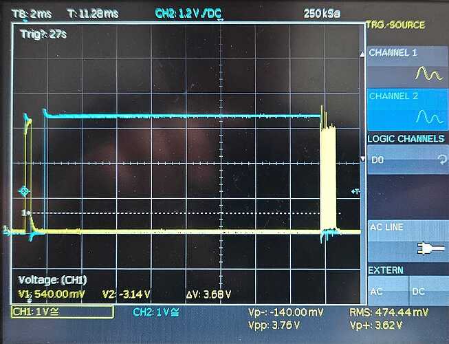

This is my waveform. Blue is CS line, and yellow is clock.
During error log it goes high for very short time, and clock goes high.
Then CS goes low, and high again. After going low clock is clocking something on MOSI line, and after that nothing visible on MISO line, and CS stays low.
Hi @benedict.hewson I suspect that driver is keeping CS1 low after MOSI transaction is finished, but dont know why. I dont have externall pull up on that pin.

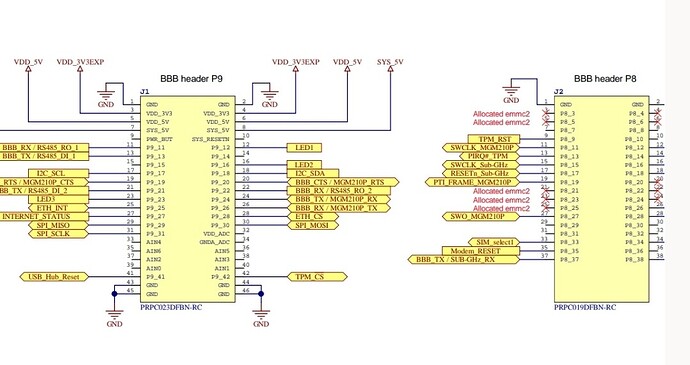

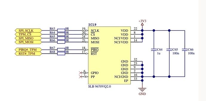

This are my schematic parts where SLB9670 connections are visible.
Any suggestion will be highly appreciated.
Thank you all!
