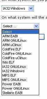

I try to download the Sourcery G++ tools and we have below options on the
Tools selection can you please let me know which tool chain I can use to
program the Beagle Board(OMAP 3530)
I guess ARM EABI?
I guess ARM EABI?
If you want to do bare-metal dev, then use ARM EABI. If you want to
do Linux dev, then use ARM GNU/Linux. I guess that since you say
you don't run any OS on the processor, the right choice is ARM EABI.
