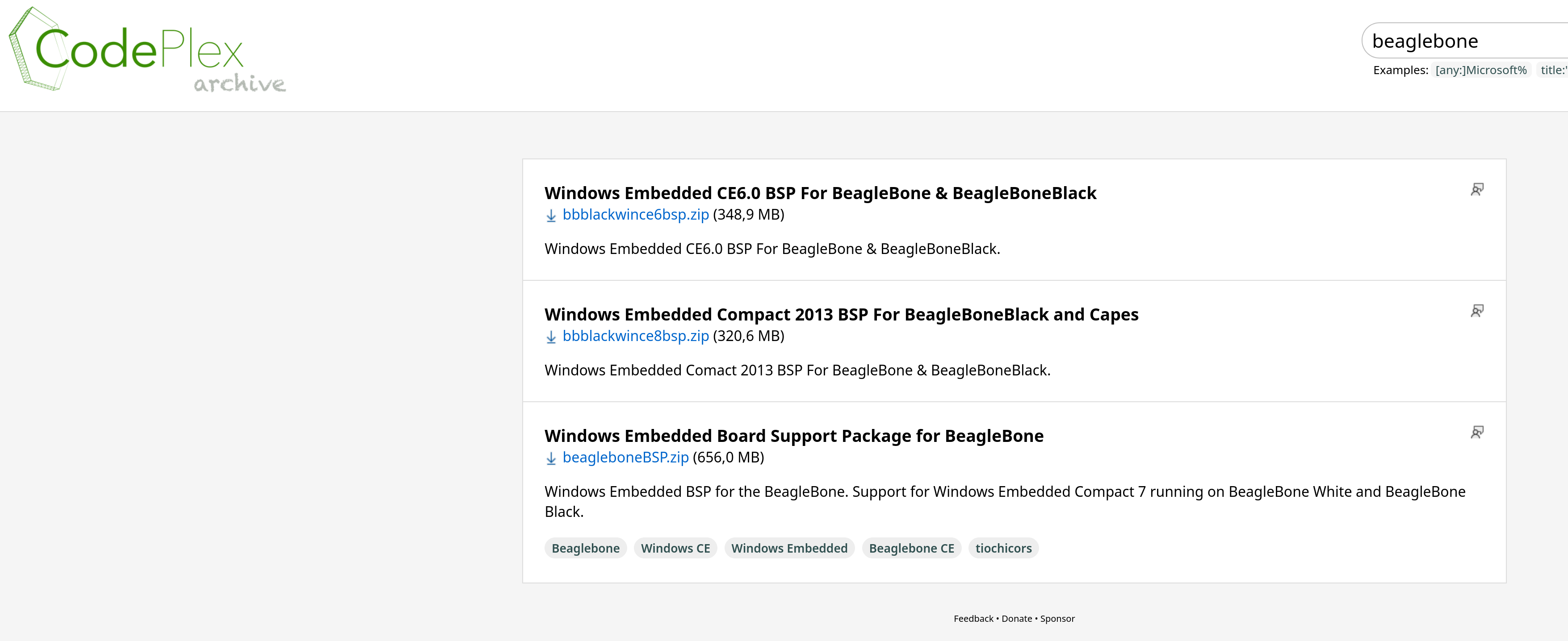

Some one else created an archive: https://codeplexarchive.org/?search=beaglebone

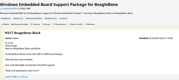

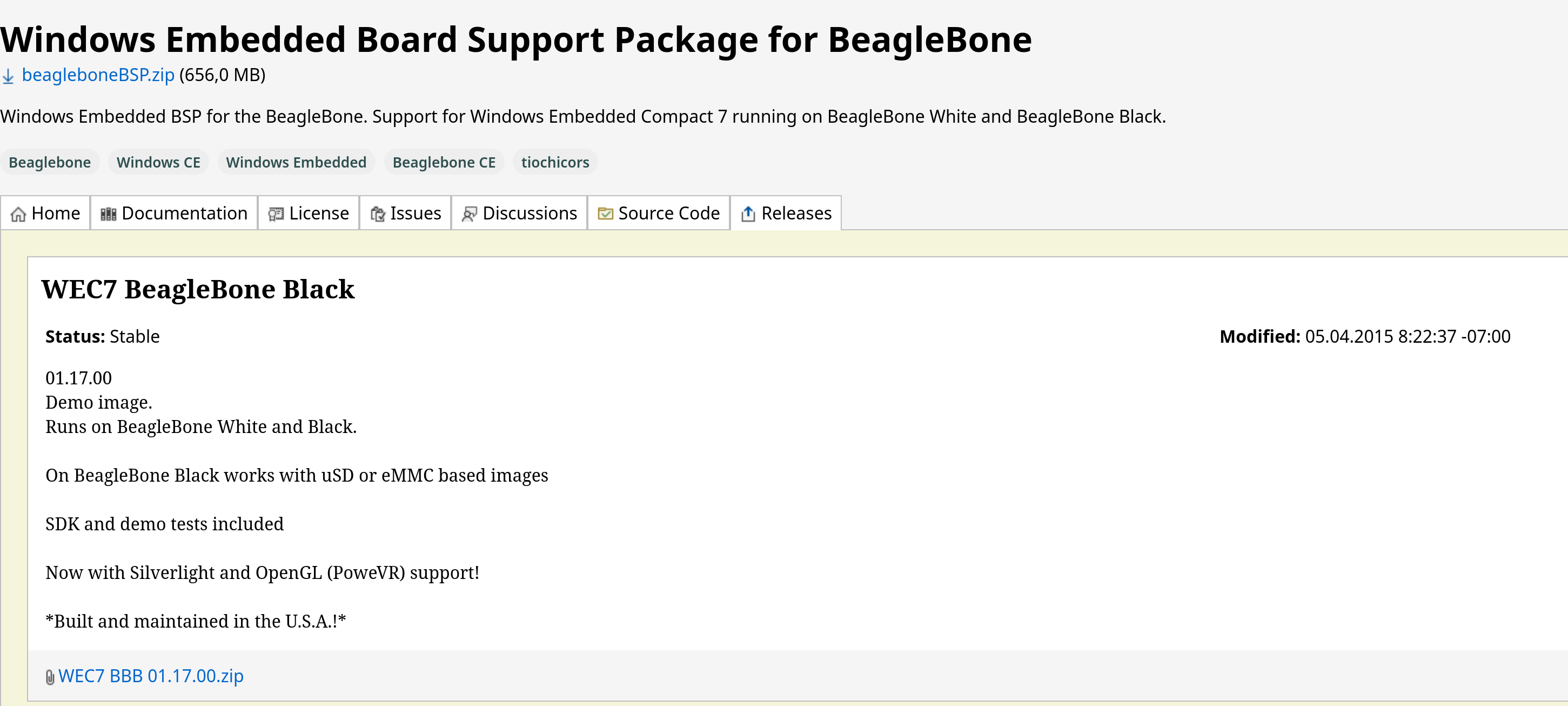

So maybe this version is what you used? https://codeplexarchive.org/project/beagleboneBSP
looks like 2015 was last:

The only information I have is that the ready-made image was downloaded from a website. No one from the development team who might have that information works at the company anymore. How did you manage to access that CodePlex archive? It’s asking me for authentication to access it.
Click “cancel” they tell you the correct login, that’s their anti-ai-anti-bots protection..
