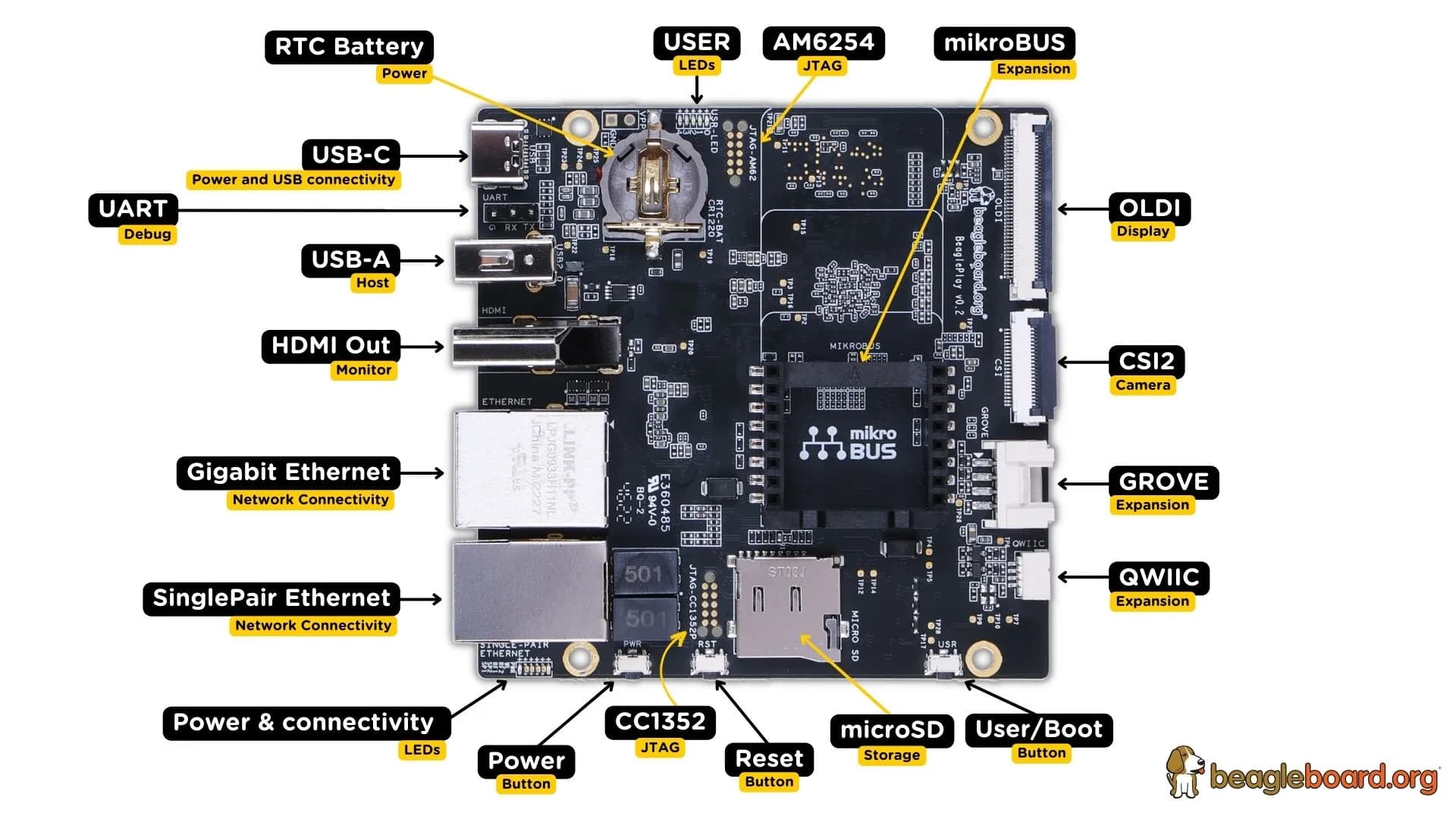

BeaglePlay SD micro can't boot
Programmable user button, also servers as boot mode slect button (SD Card/eMMC). Press down to select SD Card as boot medium

Press down USER button , plug power console can’t display . can not boot.
hehe .
  1. Rename tiboot3.bin to tiboot3-default.bin.
  2. Rename tiboot3-am62x-gp-evm.bin to tiboot3.bin.
