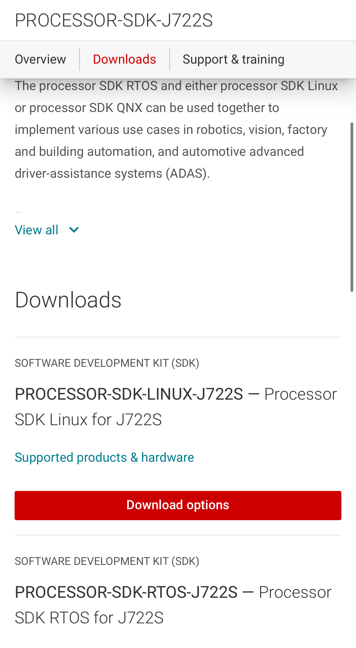

Been working on getting the i2c4 up and looking for the correct power-domain and clock, while looking found c7x stuff and it will need an overlay to turn it on. c7x is disabled. Those links are a step closer.
Here is the link. https://dr-download.ti.com/software-development/software-development-kit-sdk/MD-1bSfTnVt5d/09.02.00.05/ti-processor-sdk-rtos-j722s-evm-09_02_00_05.tar.gz you need that. Only works in Linux though.
