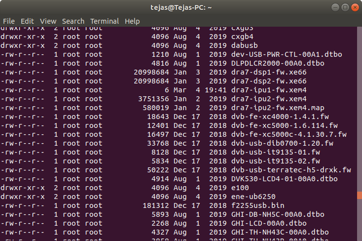

As you said “you can echo the name of your code to the firmware (place your code under /lib/firmware) and start it with echo ‘start’ > remoteprocX/state.” , Could you please explain how to do this?
Under lib/firmware folder, i found the IPU related files as mentioned in the screenshot.

The PRU is not the cortex M4
