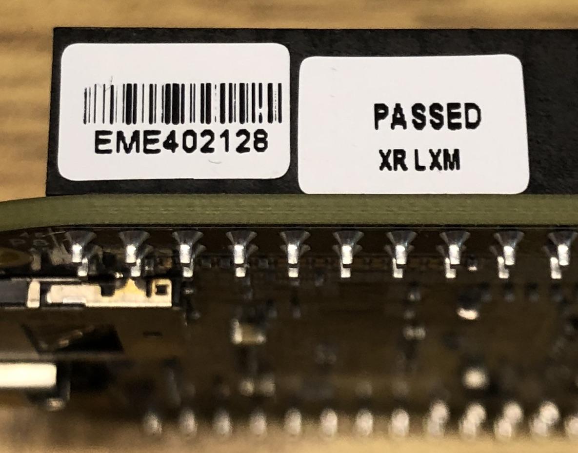

Hello Dennis, the OS is Debian 7.5, here is apicture of the side sticker.
With the j1 serial port I could see my problem was the boot process u-boot.
All the best

[image: IMG_1284.jpg]
That's pretty archaic -- the last 7.x release (at least, in my archive)
was 7.11, and that was almost 2.5 years ago. 7.5 is four years old.
The odds are very good that the u-boot that is running is designed for
kernel-time device tree loading, but since the mid-8.x Debian, the kernels
expect u-boot to load the device tree.
The image doesn't provide any information for me -- both of my BBB
units have a sticker with 0615BBBK0412 under a bar-code. At best, it
identifies a manufacturer internal stock number.
