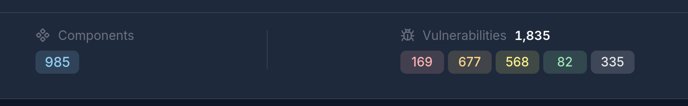

Okay finally got something exported, that i could import into one of those random online scanners…
So take this very basic: Index of /rootfs/debian-armhf-13-base-v6.18/2026-09-17
use this sbom.cdx.json and load up: https://rcn-ee.net/rootfs/debian-armhf-13-base-v6.18/2026-09-17/am335x-debian-13.7-base-v6.18-armhf-2026-09-17-4gb.sbom.cdx.json
Hey Robert, do you have any recommendations for the analyzer tool to search for the vulnerabilities? I tried to use self-hosted Dependency Track but didn’t have any luck. It consumed the SBOM but it didn’t find any vulnerabilities in any of the components
Good point… all the sbom checkers suck…

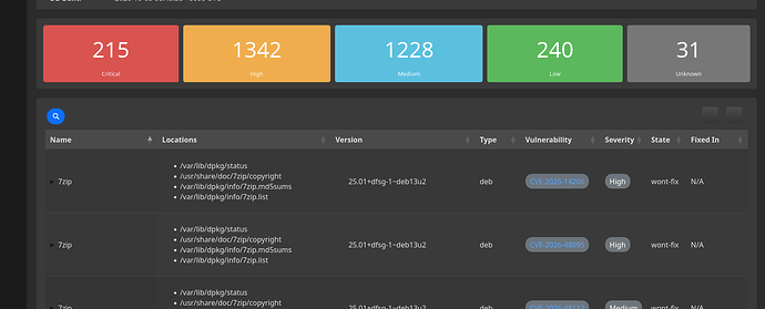

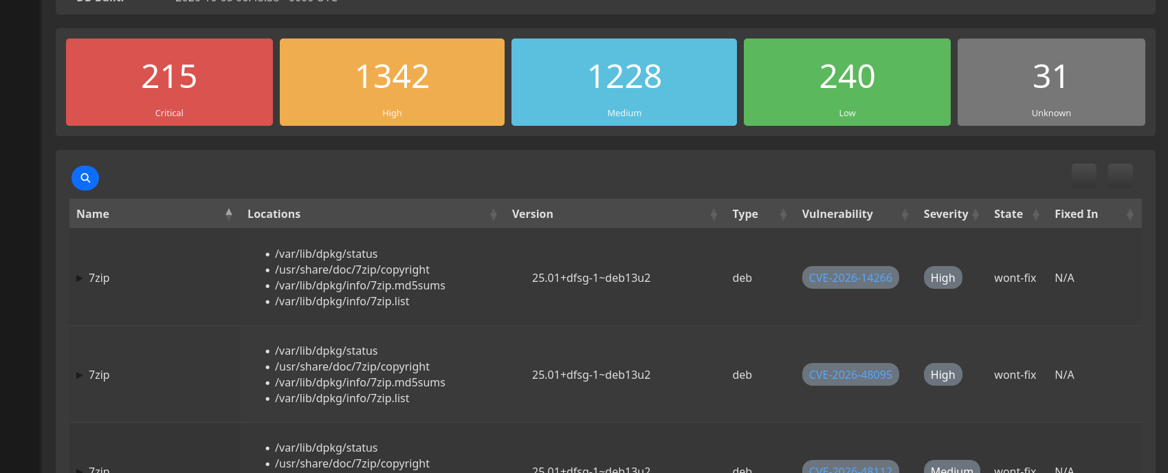

Side note… there are some templates:
Download one: grype/templates at main · anchore/grype · GitHub
grype beagleplay-debian-13.7-xfce-v6.18-k3-arm64-2026-09-20-12gb.syft.spdx.json -o template --template html.tmpl --file grype_report.html
rc’s can be done with:
grype 'cpe:2.3:o:linux:linux_kernel:7.3:rc6:*:*:*:*:*:*'
