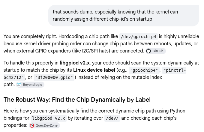

See, this is my exact error so far…
I do not know how to discuss ti,davinci-gpio on the BeagleY-AI and how to handle multiplexing pins around the images available through beagleboard.org.
Multiple Additions here:
Google Brain Here…
Source File: drivers/gpio/gpio-davinci.c
Device Tree Compatible: ti,davinci-gpio
User-Space Interface: Managed via libgpiod character devices (/dev/gpiochip*)

Okay and for Testing before the PR to Openbeagle.org and for v2 of GPIOd and so on…
  1. gpio.h has all definitive data
  2. A short listing of data can be found here: GPIO Character Device Userspace API — The Linux Kernel documentation
  3. It is definitely more complicated now than ever before today (so I say)…
  • It is like it is a cyclic thing now.
  • So, instead of simply calling /dev/gpiochipN and requesting lines and setting values, one really needs to understand the userspace cyclic ways.
  • I am trying and coming up empty for now.
  • I will continue and report findings.
It seems simply calling GPIO_V2_LINE_FLAG_INPUT as an input via the struct under a, say, gpiochipN may work but then there are other cyclic “moves” to make in userspace.
