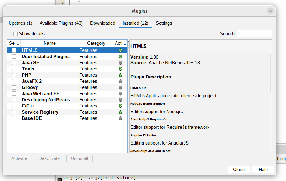

You just have to load the correct options.

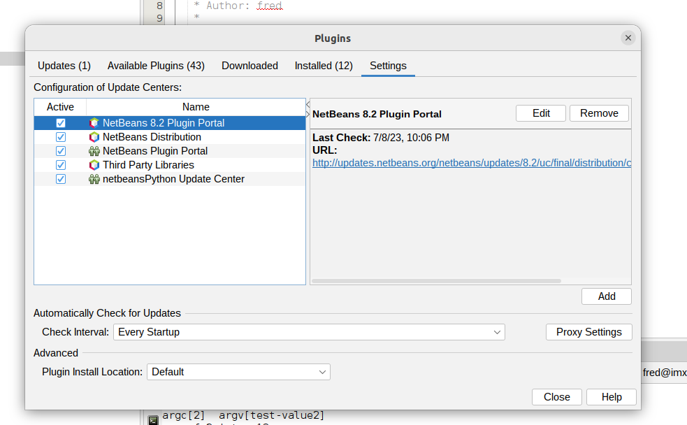

Check Netbeans 8.2 plugin portal, restart when its ready.
Go to the installed tab and activate the features shown in the above. Restart IDE. Note, the bottom bar shows the progress of the stuff downloading so wait until it is finished.

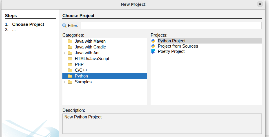

I believe you are using python.
