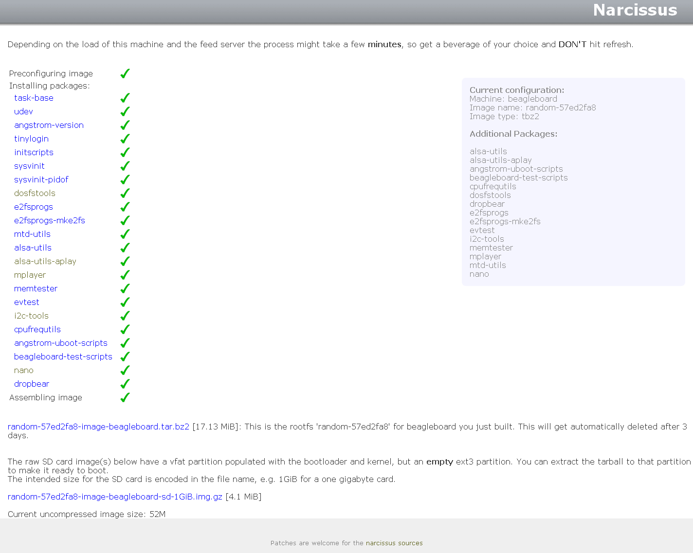

I built an image using Narcissus…
Narcissus - Online image builder for the angstrom distribution_1283257837725.png
And then I looked for the kernel inside of it…
$ tar jtf random-57ed2fa8-image-beagleboard.tar.bz2 | grep boot/uImage
./boot/uImage
./boot/uImage-2.6.32
Yup, it is there.
