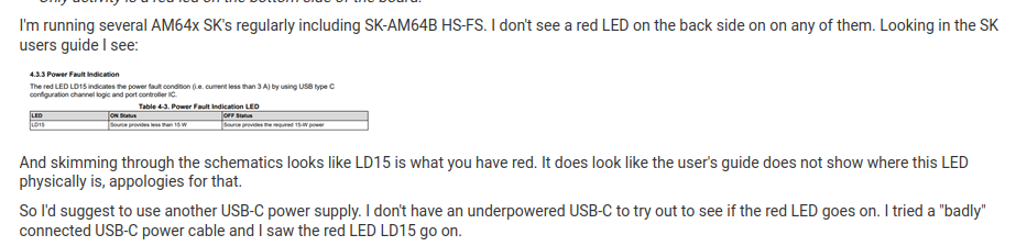

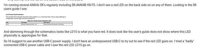

TI employee just confirmed the red LED is a power issue. So the software must be okay.
Here is what they posted.
Must be a power regulator for the AM64 is dead because the USB lights up and connects to my host.
Its not shorted out or current would be high, its only drawing around 10 ma., possibly the green LED for the USB.
