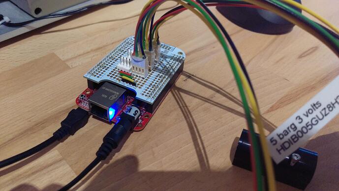

The actual hardware used in the final project with the i2c connectors soldered on to a prototyping cape looks like this:

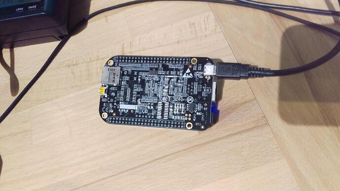

I have repeated the exact same fault on this:
Are you using a COM port in Windows to talk to a USB to serial cable, which is talking to a hardware serial port in the BBB?
I plugged the micro USB port on the BBB into my USB hub. The USB hub is currently attached to a windows PC but the same fault happens when the USB cable is plugged into my mac book running OSX.
Within a minute of the BBB being plugged in an extra COM port is added in windows. I connect to the com port with Termite (terminal program), ZOC7 (terminal program) or pyserial (the python serial library).
When I connect to the COM port I can login and get a shell. I ran some relevant commands in the shell so you can see the results.
I have repeated the exact same fault on this hardware:
