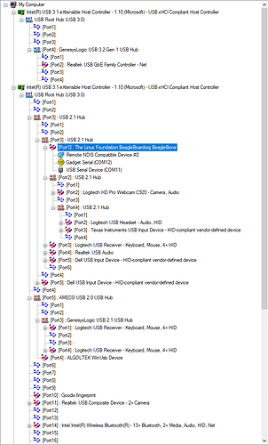

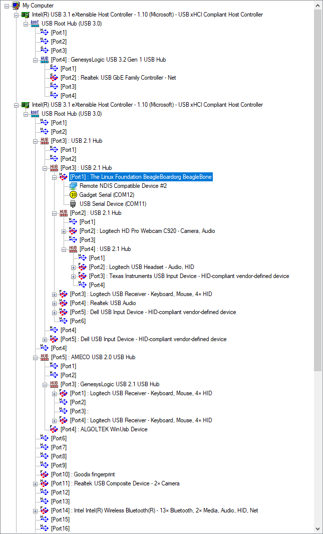

I was able to flash the SD card at home last night…not sure what was different (different laptop perhaps) --took a few tries, though.

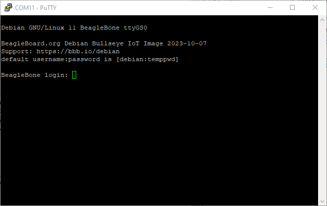

I updated the S/w on the beagle bone:
And am now able to ssh into the beaglebone – SUCCESS!!
– now on to try and see if I can get it to generate the USB test patterns
thank you very much for your patience and help!
