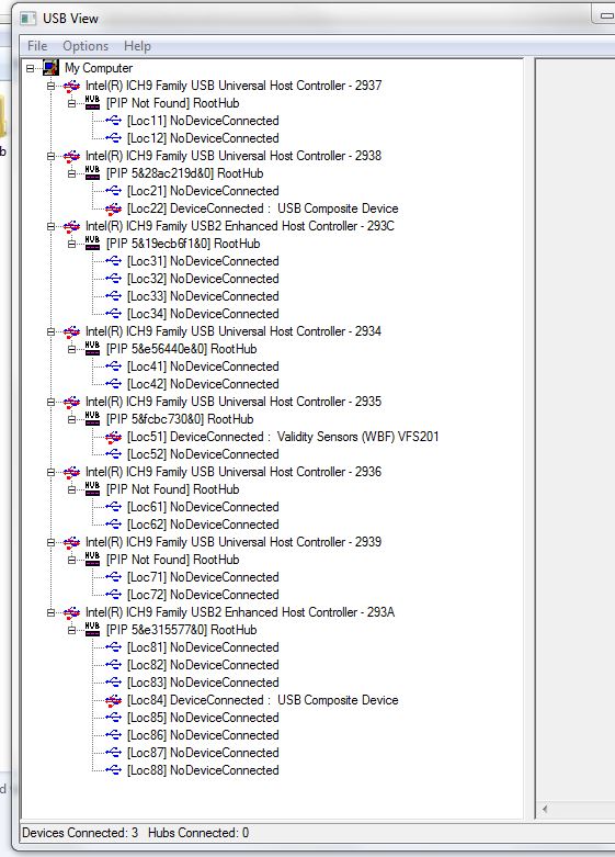

There is utility that FTDI has that lets you look at all of the USB ports. Try this and see if the USB port shows up. when plugged in and goes away if you remove it.
http://www.ftdichip.com/Support/Utilities/usbview.zip

Hey Gerald,
Attached are the screenshots… There were 3 devices connected before attaching the BBB and 3 afterwards…
I’m not sure what to do next!
Sounds like you may have damaged the USB connection then. Might as well do an RMA and get it sent in to be checked. If it tests good, well we can take it from there and see what we can figure out.
