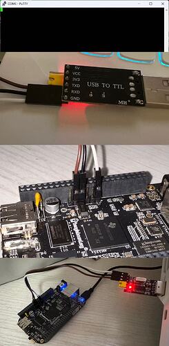

After inserting the SD card into the BBB, I held down the boot button while powering on, but none of the four status LEDs illuminate. I’m unable to establish either SSH or serial connection to the board(through PuTTY).

yes I have a USB to serial adapter, but i can’t see any output.Is there anything wrong with my connection?
With ‘nothing’ on the microSD, you’ll get a stream of CCCCCCC otherwise you’ll get u-boot info… so a good chance your TX/RX is reversed if you get nothing…
Yea, if I’m seeing those colors correctly, RX and TX are swapped.
You’ve got TX connected to TX and RX to RX… That’s wrong!
The good news is that I also see at least one-of-four Leds ON now, so it’s not completely dead.
THX!!!
This is exactly where the problem is!
