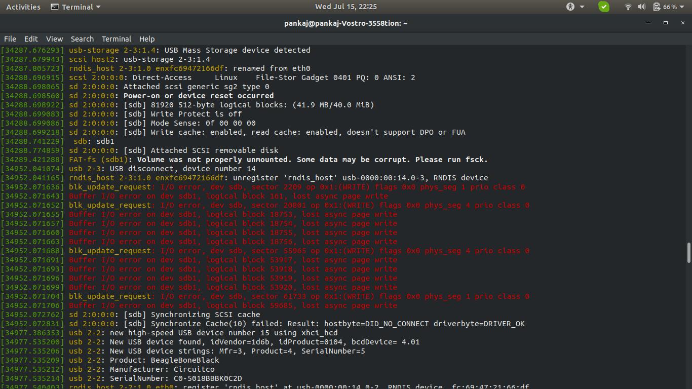

PFA for screenshots of the output message on running the command dmesg with plugged in BBB.

It is possible that you either have a bad USB cable or your PC can not provide enough power to properly power up the BBB.
The preference would be to upgrade you eMMC, however, this message does appear in your files though:
[ 8428.112630] sd 2:0:0:0: [sdb] Synchronize Cache(10) failed: Result: hostbyte=DID_NO_CONNECT driverbyte=DRIVER_OK
[ 8428.408057] usb 2-1: new high-speed USB device number 8 using xhci_hcd
[ 8428.536147] usb 2-1: Device not responding to setup address.
[ 8428.744111] usb 2-1: Device not responding to setup address.
[ 8428.952095] usb 2-1: device not accepting address 8, error -71
[ 8429.924105] usb usb2-port1: Cannot enable. Maybe the USB cable is bad?
[ 8429.924193] usb usb2-port1: attempt power cycle
[ 8431.272034] usb 2-1: new high-speed USB device number 10 using xhci_hcd
[ 8431.293196] usb 2-1: New USB device found, idVendor=1d6b, idProduct=0104, bcdDevice= 4.01
[ 8431.293200] usb 2-1: New USB device strings: Mfr=3, Product=4, SerialNumber=5
[ 8431.293202] usb 2-1: Product: BeagleBoneBlack
[ 8431.293205] usb 2-1: Manufacturer: Circuitco
[ 8431.293206] usb 2-1: SerialNumber: C0-5018BBBK0C2

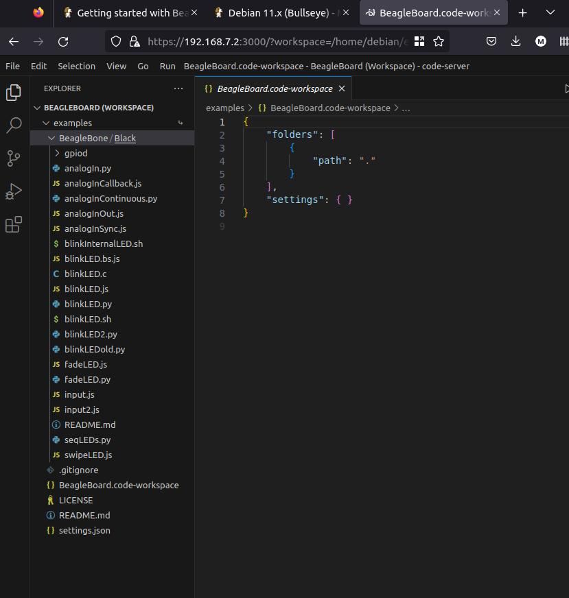

I think I figured out the issue. On opening 192.168.7.2 I was getting this page:
|460.9477124183007x255
On clicking VSCode.html, page won’t load but the port used in URL was 3000.
I was using the latest image from here
Problem was that port 3000 was disabled. It has to be enabled manually(Details)
After running sudo systemctl enable --now bb-code-server, and reloading, I was able to access VSCode.html at port 3000
Let me know if this looks all good to move forward. Thank you :slight_smile:

Hi, as shown above in the screenshot, 192.168.7.2 lands to the index/ page. But to access VSCode.html, I have to SSH into the board and only then VSCode Editor loads.
If I SSH into the board and run examples/Beagleboard/Black/seqLEDs.py, I see LEDs blinking in sequence, which means it does communicate correctly.
But, there’s no examples for BeagleBone Blue in the examples folder. Also I feel I think I am missing some other common folders(may be that will show me webpage at 192.168.7.2 instead of directory - index/).
Is this a common problem? In some tutorials I saw Cloud9 IDE making it easier to run commands for sensors directly in the terminal. Can I somehow get Cloud9 like IDE too?
Thanks in advance. Attaching my folder content.
