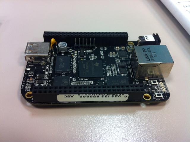

I received the A5C version, I read a little bit and found that the A6 is the latest revision.
Are there any known problems with the A5C or any improvements with the A6.
If so, I will have have to return it and get the latest one.
As I am new, I have no clue if these revisions will have any impact on my application.
Also, I noticed there is a tiny white sticker on the back of the board with Pink dot on it. Now I was wondering if that is one those water damage markers, and because there is a pink dot, I was just worried if it is showing water damage or something.
The A5C and A6 are equivalent and the changes do not affect the way it operates and is not for any known issues. We are just trying the keep the design up to date. We just made a few tweaks to comply with an errata that TI sent out. You can find information on the Wiki that describes the changes. http://circuitco.com/support/index.php?title=BeagleBoneBlack#Revision_A6_.28Production_Version.29
As to a white sticker with a pink dot, we did not put that there. We have had several reports of questionable boards from Amazon. We are not sure where the boards are coming from and in a lot of cases, no idea who the supplier is supposed to be. We have no way to track it for sure nor do the suppliers. I have heard this story from other board makers as well. That is why Amazon is not listed as a supplier by us.
I have uploaded images of the board it self. I dont know how helpful this will be.
Do you know if the BBB boards sold by amazon are legitimate? Or chinese knockoffs?
I mean are they known to fail or be defective?
Amazon claimed that the seller was Logic Supply. I check their website and the beagleboard website. Logic supply is one of the distributors listed on the beagleboard website.
I doubt they are knock offs. What happens is that sometimes a person will buy a board, blow it up, send it back and gets a new one. The blown up board ends up in somebody else UPS box.
There is a way we can tell if it is knock off, but we have to have it, not just pictures.
But, as long as your board is working and boots up, you should be OK. You might send an email to Logic and ask them about the red dot.
