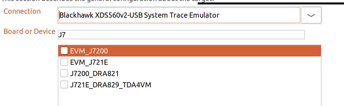

Planning to get a debugger for use with AI-64. Currently, thinking between Segger J-Link Ultra+ and BlackHawk TMDSEMU560v2STM-U. Any inputs in this regard would mean a lot.

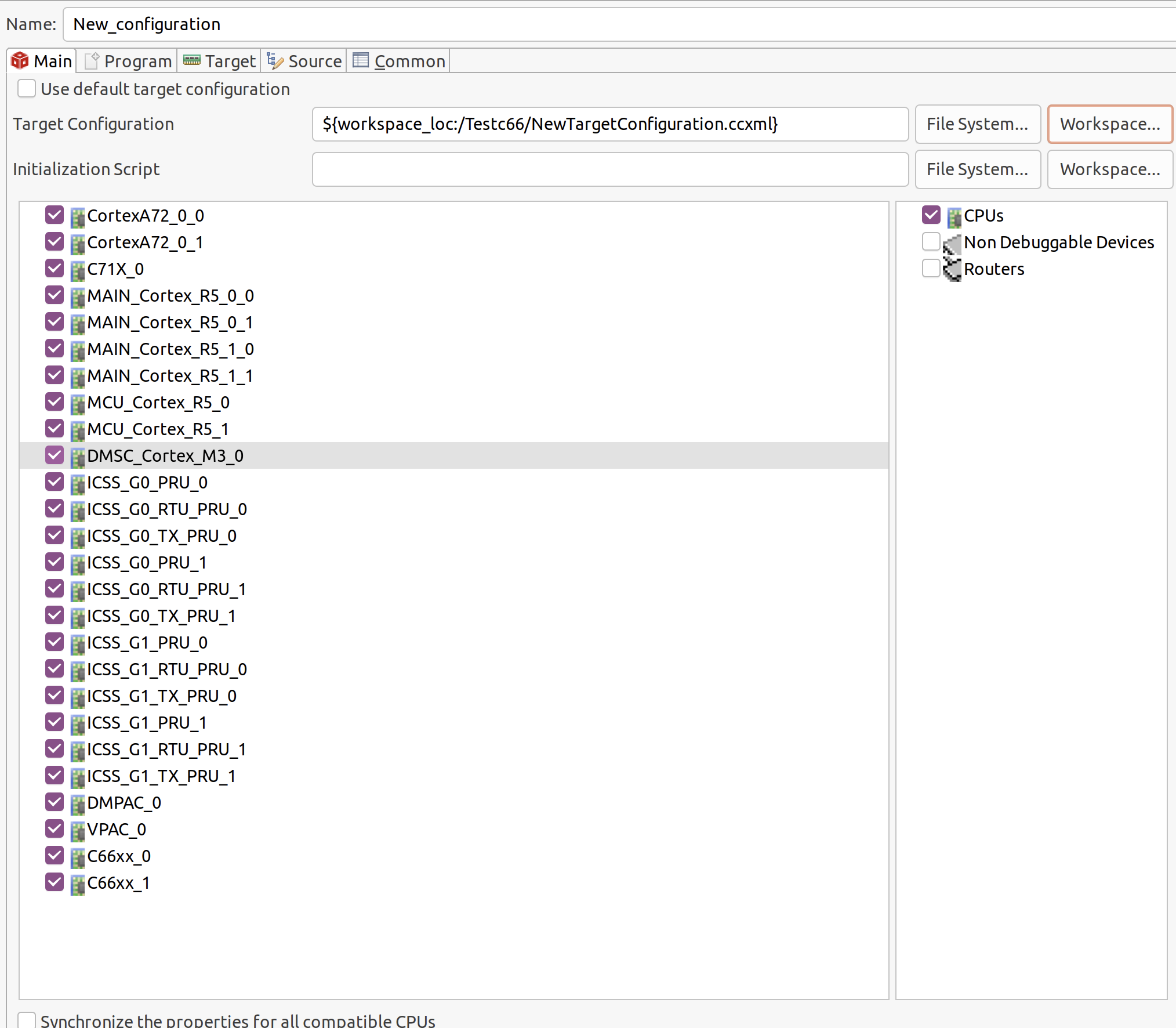

Note: 560v2 has the advantage of supporting C66x DSP core but whether it is possible to debug the C66x core using 10-pin ARM JTAG port in AI-64?
