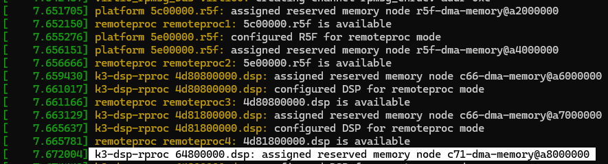

Hi @jkridner, which one of these remoteproc addresses (4d80800000.dsp , 4d81800000.dsp, 64800000.dsp )
correspond to C71xDSP ?? Thank you in advance !!
64800000.dsp corresponds with the C71 DSP.
Thanks!!
Can you please share the command that you wrote on the terminal to see this.
For that screenshot I used dmesg to check the kernel logs. The correct way to find this information is to take look at the device tree. After all, the kernel gets the core address info from the DT.
