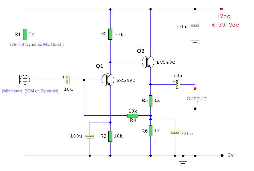

I built an electret Mic preamp with a couple of BC109C transistors and it recorded though the played back sound is heavily distorted, confirmed by copying the .wav file to a x86_64 box.
I shall have to play with the preamp output to see if I can get a clean signal recorded.
did you limit the input bandwidth to avoid aliasing?
I just built the circuit and tried it.
