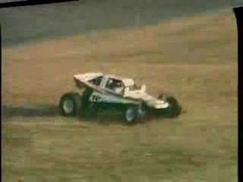

Update
I found an older model video of the Tamiya GrassHopper that I will use on Youtube:
Check it out!
'83!
Yes, remember those. Back then I was flying a Cricket RC heli, that was before the really cool tail rotor gyro was around.
