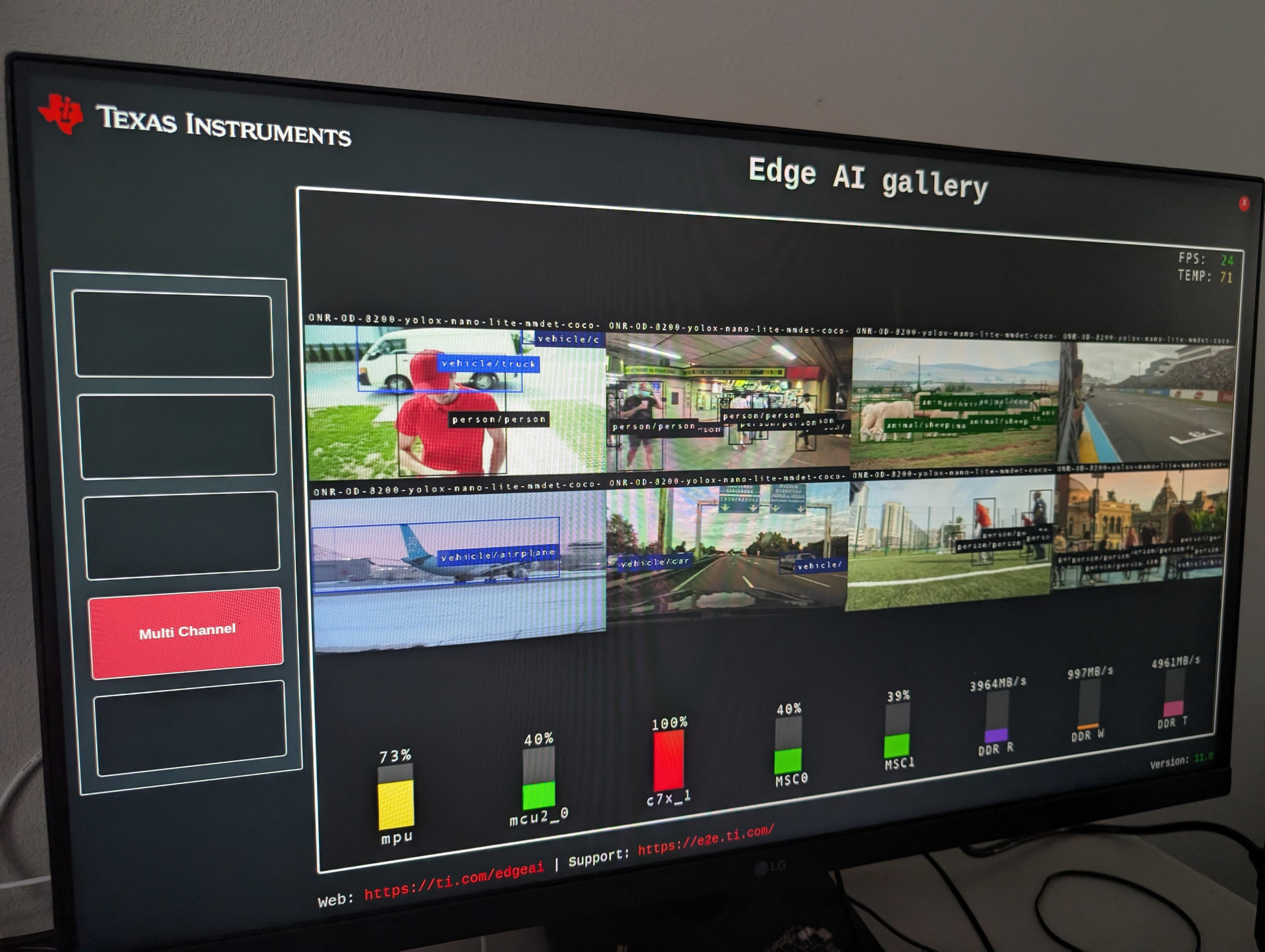

[BBAI64] Basic Edge AI stack Yocto build now working with TISDK 11.00
I have gotten the basic EdgeAI stack working with a Yocto TI SDK11.00 build. I am successfully running the models from the Edge AI Gallery app.

Build the Edge AI image:
bitbake -k tisdk-edgeai-image
This build takes 8-10 hours on my system with a Ryzen 7 7840u with 64gigs of ram. The build takes 14 hours when built from WSL. You will needs a 1/2TB of free space on your disk.
Running the image
Flash tisdk-edgeai-image-beaglebone-ai64.rootfs.wic.xz from ~/tisdk/build/deploy-ti/images/beaglebone-ai64/.
Make sure to supply your board with enough power. It will freeze up and shutdown if not supplied with enough power to run models…
