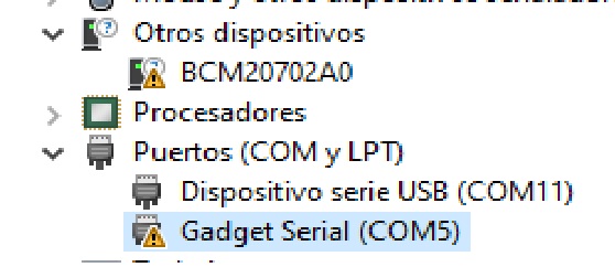

I have a problem with my BBB because i installed the drivers but the gadget serial appears the next form:
serial
appears with exclamation symbol and when I try to open the embebed web site of the BBB (192.168.7.2) apperars just this:
