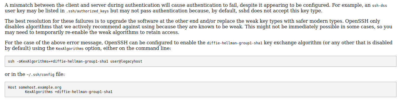

Don’t have a clue on this, however did find some stuff that is relevant on the openssh site.
http://www.openssh.com/legacy.html

Don’t know why it starting working since I since more than one thing. First I suspected an open connection over usb could be messing with things though I had once closed with no success, A note of what worked for them was
`Host bbb
KexAlgorithms +diffie-hellman-group1-sha1 +diffie-hellman-group-exchange-sha1
User user
Hostname bbb
and I changed password authentication = yes which did not work by itself.
But with all changed and deleting the 192.168.7.2 sha in .ssh It starting working.
