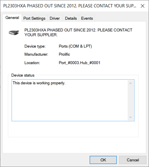

Windows 8/8.1/10 are NOT supported in PL-2303HXA and PL-2303X EOL chip
versions.

Thanks Jon, for the link. I tried modifying my current driver installation. It still shows the same error.
Although, now the board boots up but the serial connection gets dropped. The serial and power connections are somehow still mutually exclusive. The serial connection appears only when I turn off and plug out the micro-USB (power).
