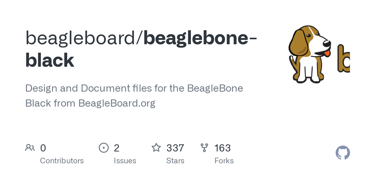

P.S. If you need help w/ specific components on the BBB, the Open Hardware design is listed online at github.
