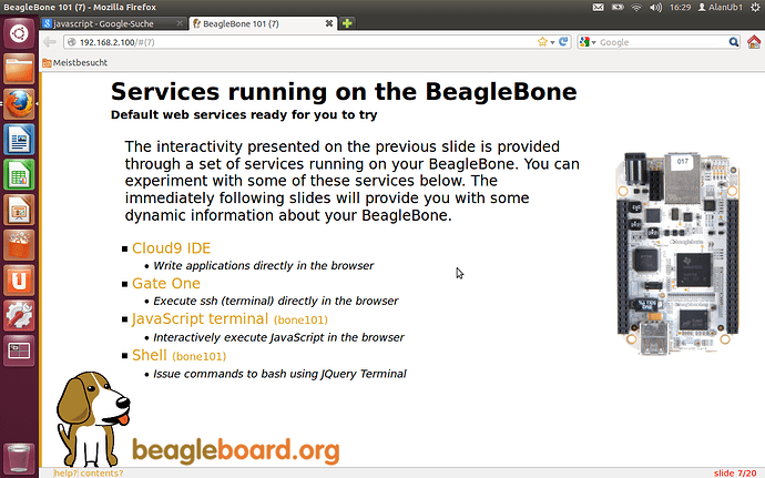

The following appears to work okay (connecting via ethernet to router):
- access via a terminal
- via the browser (Firefox): access to beaglebone.local and access to the
JavaScript terminal (bone101)and the Shell (bone101).

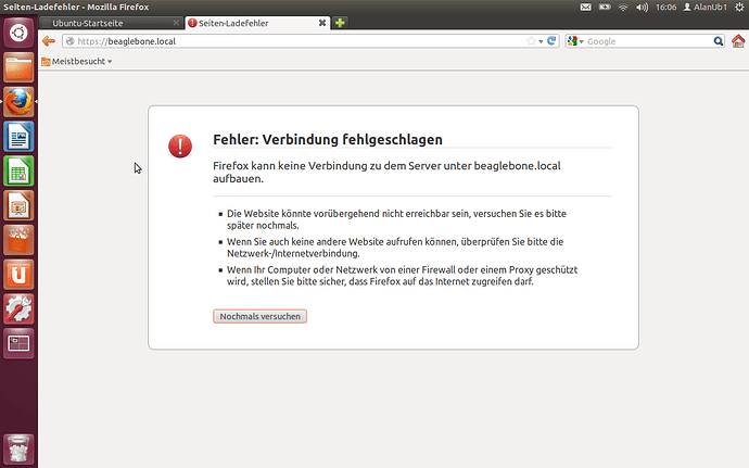

The following does not work:
- via the browser: attempting to access Gate One fails to connect
Get on the latest demo image. Make sure you accept the lack of
certificate on the page. Perhaps the port should be moved to avoid
this issue?

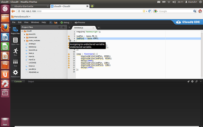

- via the browser: accessing Cloud 9 is succesful but all .js files show
errors. For example blinkled.js shows either "assigning to undeclared
variable" and/or "undeclared variable" at lines 3,4,6,7,8,11,12,13,14,15,16
and 17.
That is a style issue that isn't easy to resolve. I'm declaring global
variables in Bonescript and that is not typically desired. I'm doing
it for the purpose of simplifying access to the functions. Perhaps it
would be better to avoid polluting the global namespace and force
people using Bonescript to learn this basic aspect of JavaScript by
giving them a cleaner example.
  • access via a terminal
  • via the browser (Firefox): access to beaglebone.local and access to the
  • via the browser: attempting to access Gate One fails to connect
this issue?
  • via the browser: accessing Cloud 9 is succesful but all .js files show
    errors. For example blinkled.js shows either “assigning to undeclared
    variable” and/or “undeclared variable” at lines 3,4,6,7,8,11,12,13,14,15,16
    and 17.
That is a style issue that isn’t easy to resolve. I’m declaring global
variables in Bonescript and that is not typically desired. I’m doing
But this doesn´t seem to cause problems with other users, am I doing something wrong?
> the
this issue?
> and 17.

Can you tell a bit more about what you mean by "all *.js files
unusable"? Perhaps capture your screen to make it really clear?

Sorry, I should have said Gate One not Cloud One. If I attempt to connect to Gate One from the bone101 page 7 the error message “fault: connection failed” is displayed.
The Cloud9 IDE appears to work okay but all the *.js files in the Project Files (analog.js, blinkled.js, bone101.js, fade.js, input.js, input2.js, loops.js and parallel.js) show the same errors (assigning to undeclared variable, undeclared variable) see attachment.
I´m using Firefox as a browser.

Gate One does not work at all (fails to connect). With BeagleBone bash above I was referring to the Shell (bone101) called from BeagleBone 101(7). The bash terminal which opens seems to work okay.
>> > show
>> > and 17.
Gate One from the bone101 page 7 the error message "fault: connection
failed" is displayed.
Can you give a picture of that error? Likely this is due to the fact
that the https port is being used, but a valid certificate is not
supplied. You'll need to accept the supplied certificate manually.
On Chrome, I get the following message:
The site's security certificate is not trusted!
You attempted to reach beaglebone-2.local, but the server presented a
certificate issued by an entity that is not trusted by your computer's
operating system. This may mean that the server has generated its own
security credentials, which Google Chrome cannot rely on for identity
information, or an attacker may be trying to intercept your
communications.
You should not proceed, especially if you have never seen this warning
before for this site.
At this point, I click "proceed anyway" because I know I'm connected
to my own board and I'm not sharing any secure information over the
connection.
You might be able to import the certificate into your trusted list.
Read more here for Chrome, but Firefox should be similar:
Yeah, this is the style issue I was mentioning. These are warnings,
not an indication that the applications won't work. Currently, I make
a lot of use of global assignment as it is simpler than trying to
understand variable scoping. The IDE suggests against that and thus
generates those warnings. You should be able to run the scripts just
fine.

Do you mean Cloud9 IDE (JavaScript IDE for developing apps with the
Bonescript library served up at http://beaglebone.local:3000), Gate
One (ssh shell using the web browser served up at
https://beaglebone.local) or bone101 (demonstration Bonescript
application served up at http://beaglebone.local)? Haven’t you been
issuing the commands through Cloud9 IDE? I’m still assuming you have
been based on the command line errors you reported.
supplied. You’ll need to accept the supplied certificate manually.
It doesn´t appear to be a certificate problem, no mention is made of a certifecate, it simply shows that Firefox is unable to make a connection to the server beaglebone.local. The first attachment simply shows the bb101(7) page where I click the Gate One link. The second attachment shows the error message which is then displayed. If I click “back” in Firefox it returns to the bb101(7) page which is still okay since I can click the Cloud9 link and it opens correctly. Also I can successfully connect to the bone via a Ubuntu terminal so I could just use that but it would nice to know what is causing the Gate One problem.
The site’s security certificate is not trusted!
certificate issued by an entity that is not trusted by your computer’s
communications.
At this point, I click “proceed anyway” because I know I’m connected
to my own board and I’m not sharing any secure information over the
connection.
http://superuser.com/questions/27268/how-do-i-disable-the-warning-chrome-gives-if-a-security-certificate-is-not-trust
not an indication that the applications won’t work. Currently, I make
fine.
