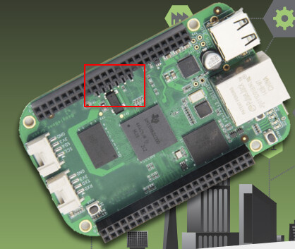

@foxsquirrel want’s you to connect a serial-to-usb adapter to this header here:
(Baud rate is 115200)
Remember, it needs to be a 3.3V type to prevent damaging your Beagle!
This won’t fix your problem off hand, but it will provide us with a better
picture as to what’s going on as your Beagle tries to start.

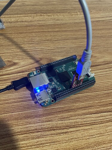

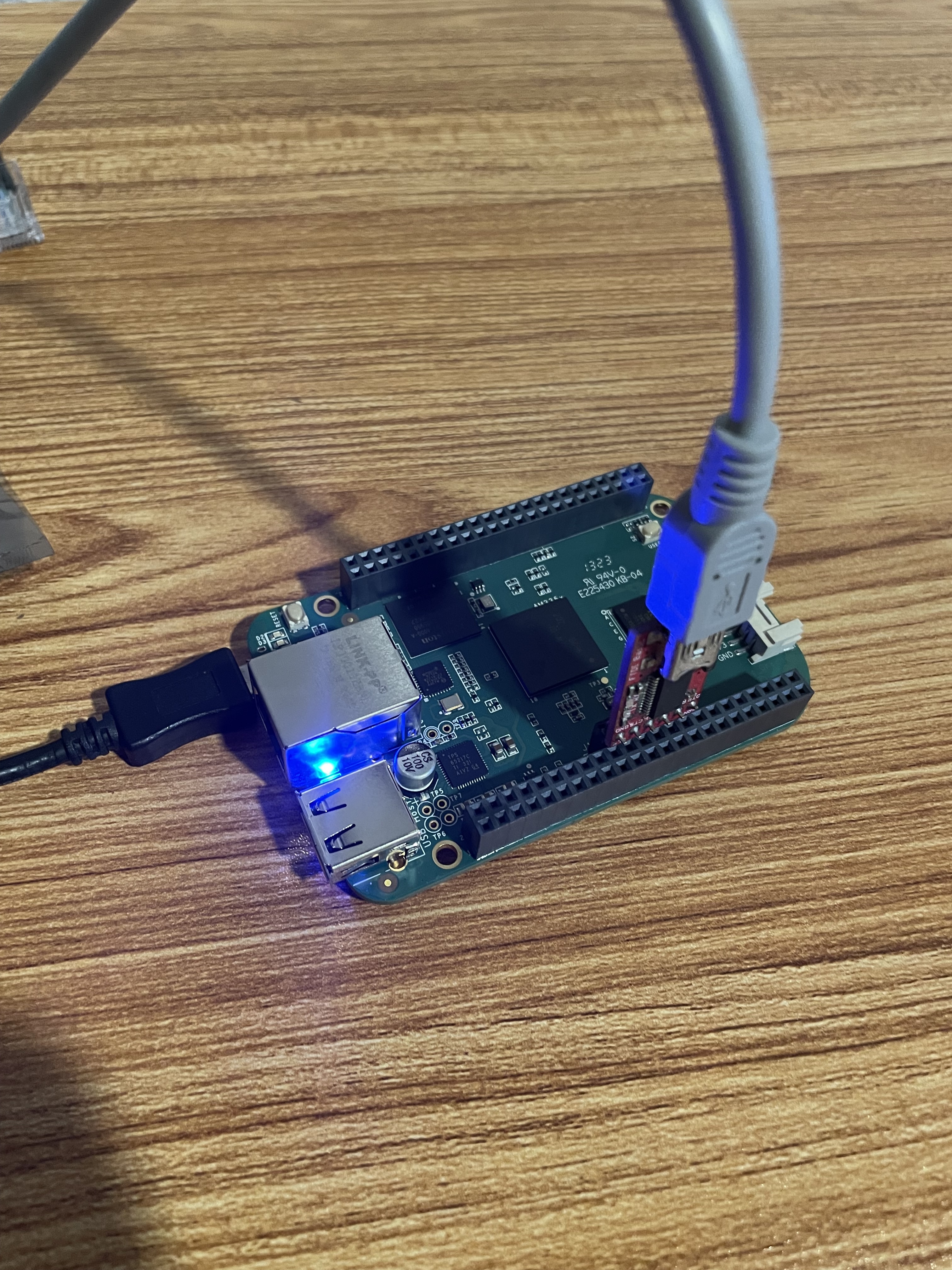

I plugged a 3.3v sparkfun FTDI cable in with GND towards the ethernet & USB ports and listened at 115200 but get no serial data whatsoever (tx led lights when I type but no rx led action). There is absolutely no action on the usr leds either, seems like the boot process isn’t even starting. For a bit more context, this issue came up only plugging/unplugging the micro USB port. No other capes or connections. The power led is constantly on when plugged in.

Are you sure that is connected correctly. It should have something. Also, if your host is a VM that will be a problem with the USB. The absolute worst case you should see a string of “C” out the port. If everything with the debug cable/host is correct and nothing out, Its done.
@foxsquirrel That’s what I read about, but no, I get nothing. I’m connected directly to my MacBook, no VM. I tried multiple serial monitors including Arduino Serial Monitor. Here’s my setup:
I’m bet I’m just missing something simple just not sure what.
