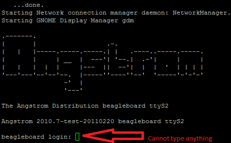

Dear Gerald,
Thank you so much for your comment. I install Angstrom 99% successfully from your link, (I enclose the photo).
I want to login as root, but I cannot type anything more.
I try to reset the BB, but got the same problems.
My BB-xM is version RevB, but according to your instructions, just BB-xM RevC image is available.
So, I installed it into my BB-xN RevB.
Is that the reason as I cannot login?
Thank you so much, my friend.
Best wishes.
According to your instructions, I installed 99% successfully,
(the photo attached).
But, I cannot login as root, I cannot type anything.
I try to reset the board, but got the same problems.
My BB-xM is RevB, but I used a BB-xM RevC Image to install. (from your link).
Is that the reason?
Thanks you so much, my friend.
