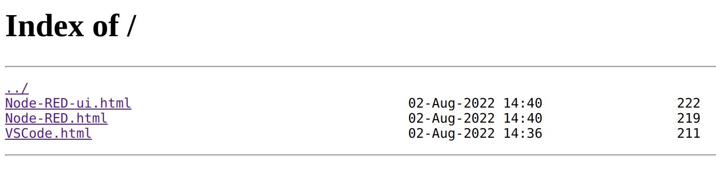

I currently do not have any adaptor connecting to the USART0. I was trying to follow these instructions on the paper. But my monitor display shows nothing. I was able to boot it up through the eMMC but I had to use my Linux computer and changing the port to 3000 to do that. See image attached.
I’m not an html person… so i’m setting these up:

package updated:
Added config to image builder, so the next version will have this configured…
To update an existing image:
sudo apt update
sudo apt upgrade
sudo cp -v /etc/bbb.io/templates/nginx/nginx-autoindex /etc/nginx/sites-enabled/default
'/etc/bbb.io/templates/nginx/nginx-autoindex' -> '/etc/nginx/sites-enabled/default'
sudo cp -v /etc/bbb.io/templates/nginx/*.html /var/www/html/
'/etc/bbb.io/templates/nginx/Node-RED-ui.html' -> '/var/www/html/Node-RED-ui.html'
'/etc/bbb.io/templates/nginx/Node-RED.html' -> '/var/www/html/Node-RED.html'
'/etc/bbb.io/templates/nginx/VSCode.html' -> '/var/www/html/VSCode.html'
sudo rm -f /var/www/html/index.nginx-debian.html
