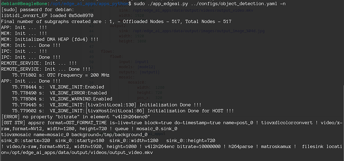

Hello Rahul,
Thanks for the reply.
I tried with option -n and here is the output. I get bitrate command not found error.
When I edit the python script ‘gst_wrapper.py’ and remove the bitrate=10000000 option. It crashes like earlier (see below)
