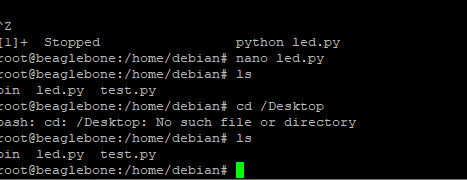

hello gang, I’m having problems at the moment of wanting to turn on a led. I am using PUtty to enter the card and to program I use python. When I run a program or print a message, it works correctly. the problem is as if the pins of the card do not work for me. I don’t know if I should use a library to activate them. I have updated the card and nothing. I have seen a lot of information and it has not worked for me.

First... Please don't use screen grabs. Everything I know of -- and
especially PuTTY -- allows one to select, copy, and paste the TEXT.
Second... Show us the CODE. All your screen grab illustrates is that
you invoked an editor, and then ran listings of the directory contents
showing that some files exist.
Without the code, it is impossible to provide advice. How are you
trying to access the pins? Using sysfs references? Is the pin even set up
for GPIO or is it defined for some other usage? Adafruit_BBIO?
Adafruit_blinka/CircuitPython libraries?
