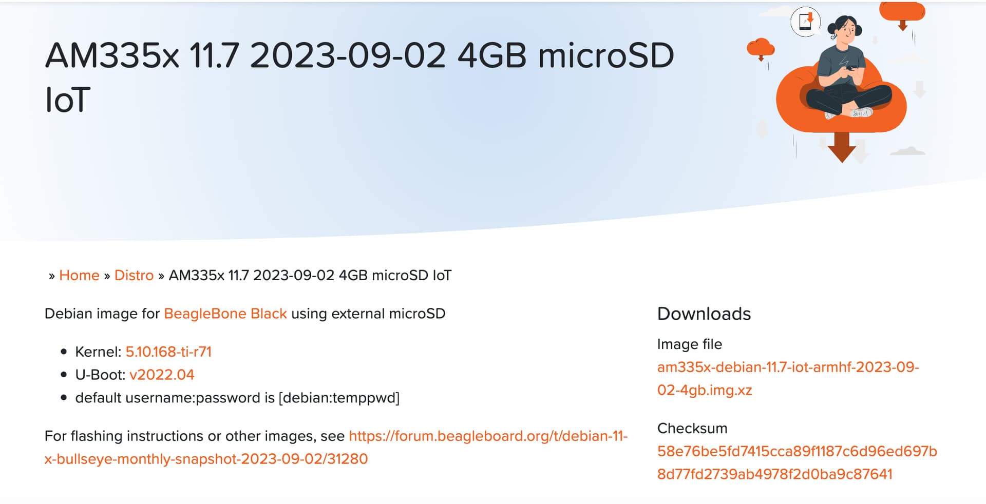

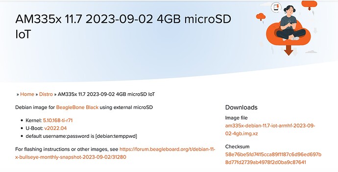

and what image (file name) did you flash to the microSD?
nope I didnt use that, we dont have a cable like that =/
I used this image to flash the µSD card:
