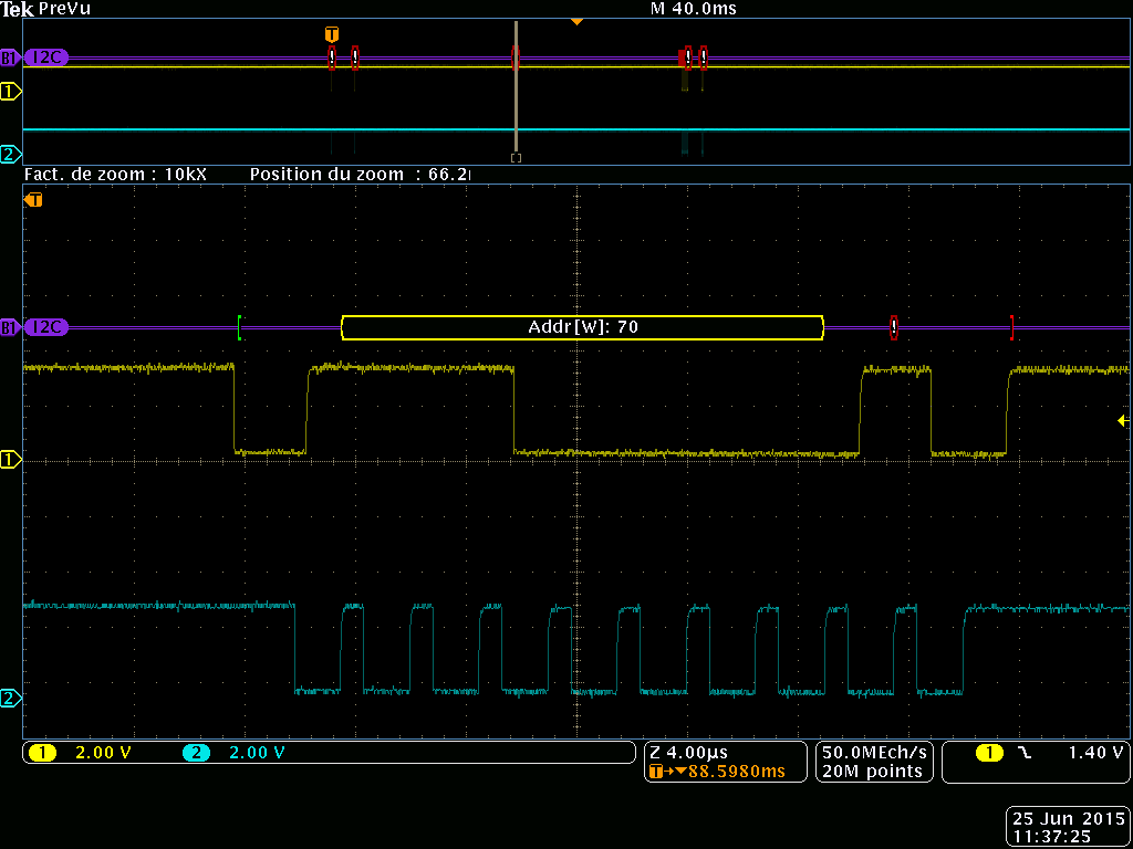

I wanted to know if the HDMI works well with the BBB and Kernel 4.1 ?
Because, I’m having issue with the Kernel 4.1 and a clone of BBB .
The kernel say :
[ 7.816539] tda998x 0-0070: set_page 000a err -121
[ 7.873069] tda998x 0-0070: set_page 000a err -121
[ 7.933820] tda998x 0-0070: set_page 0001 err -121
The oscilloscope give :
I don’t know if it’s a hardware problem or a kernel problem …
