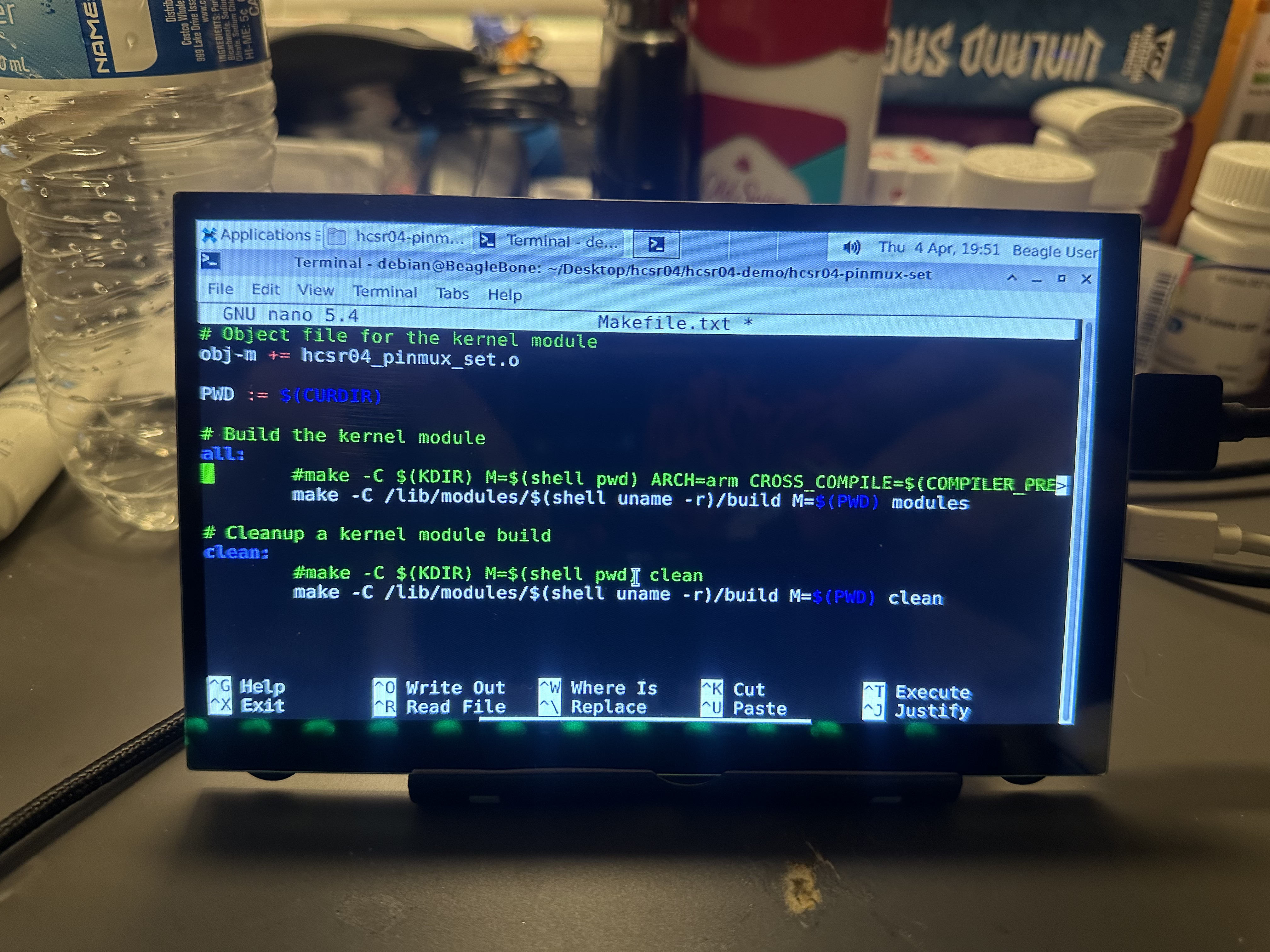

hello I am currently testing out some sonar stuff and I have a kernel module for the pin configuration but when I hit make it gives me the error: “make: *** No targets specified and no makefile found. Stop.”
Attached is a picture of my Makefile.txt. Thank you.
Hello…you say Makefile.txt is pictured.
Did you just want to call it Makefile and not Makefile.txt, maybe?
