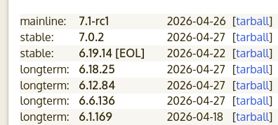

6.19 is not an LTS branch, and went EOL last week:
6.18.x is the main LTS till some 7.2/7.3/7.4 version around December 2026…
So yeah, long term right now, 6.18.x is your best bet..

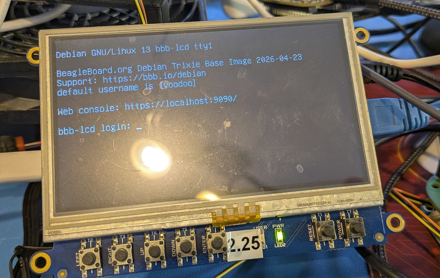

I don’t currently have access to the serial port but I did get it working.
My plan on decompiling my working dtbo file and recompiling did not work, so I ended up downloading overlay from devicetrees and modified to remove buttons then did a compile/build using cpp -nostdinc -undef -x assembler-with-cpp -I/usr/src/linux-headers-6.18.23-bone28/include BB-BONE-LCD4-01-00A1-mod.dtso | dtc -W no-unit_address_vs_reg -O dtb -o BB-BONE-LCD4-01-00A1.dtbo - and copied sudo cp BB-BONE-LCD4-01-00A1.dtbo /boot/dtbs/6.18.23-bone28/overlays/ to install.

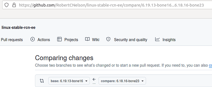

I’ve been using the compare function at git hub.
The driver was updated somewhere between 6-18.16 bone23 and 6.19.13 bone16. Maybe Robert can let you know what image to download.

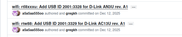

I was running the 6.18.x kernel with an older USB wifi adapter. Everything was fine. I ordered some new adapters, same brand and manufacturer. When I tried to use them, they did not work. That’s when I upgraded my kernel. The new rtw88_8821cu worked with the new adapters. So seems there was a hardware update that broke the old software driver. Seems fixed now though.
Although on reboot startup, occasionally, I get some fatal errors. Seems this is due to the adapter hardware not getting reset properly. It rarely happens, but I may look into it when I get some time. The rtw88_8821cu driver should reset the hardware on shutdown and reboot. Something is still not perfect here.
