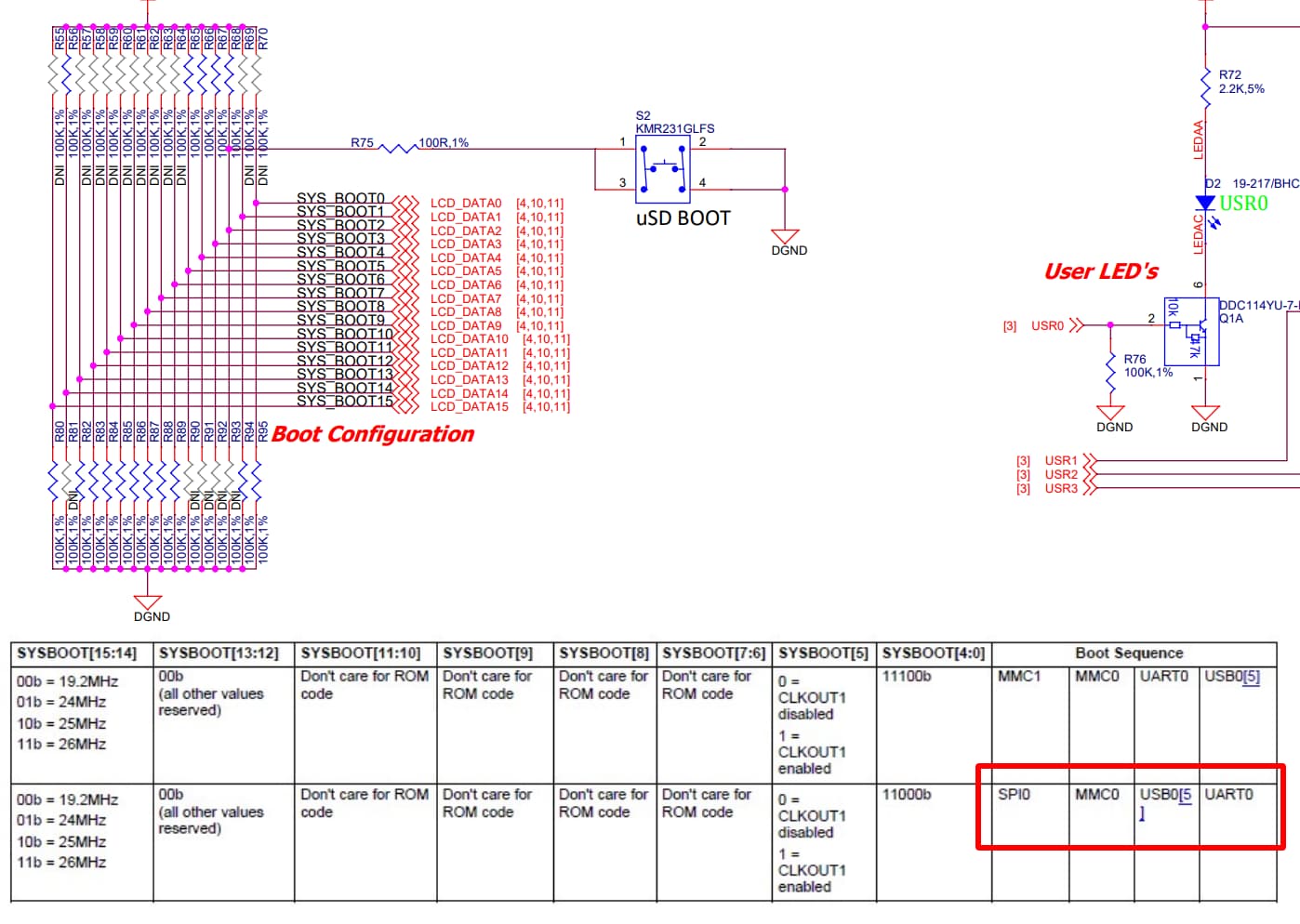

Actually, we are designing a board from the ground up. We need to fit the necessary components of the board in as well as motor drivers for our device, so there’s going to be no physical memory on the board.
So do you think this looks good then?
That looks good as long as you want microSD boot…
- SPI0
- MMC0 - microSD
