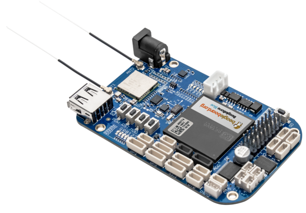

I am looking for the mechanical dimensions of the Beaglebone Blue board. I can’t find anything except for the dimensions for the Black. Are they the same?

Thanks, but I am after details of the hole spacing to mount the board. I can find them for the Black but no information on the Blue…are they the same dimensions?
There is a 3d model on GrabCad, step files and fusion 360 files. Might be of help.
BeagleBlue 3D model
Checking the step file, the dimensions ( hole to hole) look the same (assuming the step model is correct)
