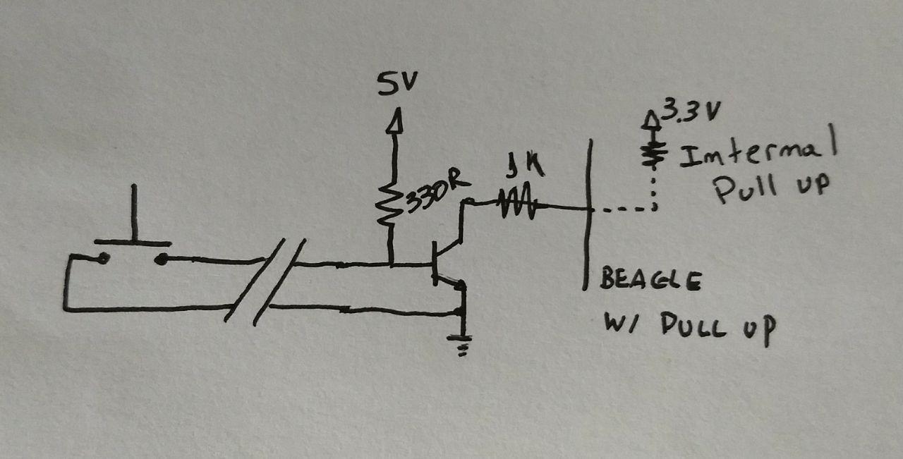

I have it all configured and runs mostly OK. I am having an issue with end switch circuitry.
The switched are connected to P8_41 and P8_42 and are connected through the circuit in the attachment (BJT with open collector, connected through load resistor and internal pullup). If the end switch is opened, the board wont boot at all. If the end switch is closed, the board boots without any further issue.

You have apparently used two pins that conflict with the boot configuration pins on the BBB, or the eMMC.
Read the “BeagleBone Black System Reference Manual” (Version C.1), pages 62, 63, 68, 82, 106, 107.

Thanks, Graham. You are correct. I have already used these pins before, but for output purposes, so, I had no issues with that. But, since using as inputs, the switches are driving the pins and changing the SYSBOOT (aka LCDDATA) bus, which I had no idea that existed for my unfortunate surprise. I guess I’ll have to redesign my boards including a tristate buffer.
