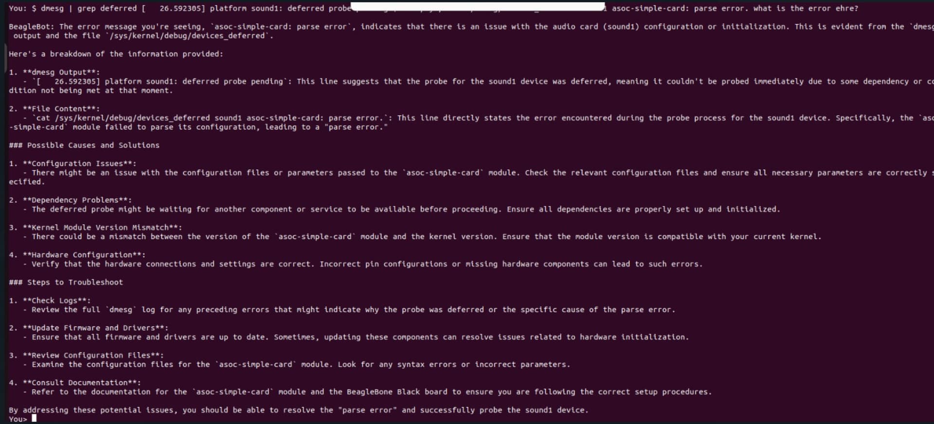

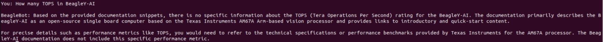

Hello @vovw,
First of all, I apologize for the late reply. I was caught up with a few task deadlines and a tight exam schedule. Secondly, you’ve done a great job. Building a working prototype during the contributors’ period demonstrates some real effort.
My feedback
I found it challenging to set up initially because there are no instructions on how to download the model. Additionally, there are some missing dependencies, such as faiss-cpu and sentence-transformers . It took some extra time to sort all this out. This can be corrected, so it’s not a big problem.
Moving on to test results:-
I tried testing the model on both Mac and Linux. On Mac, it just refused to give any result. The time taken to produce a single token was huge, and I’m not sure why. On Linux, things were decent, but the time to first token, latency, and throughput all need to be refined to a good level. Currently, a single prompt is taking 2-5 minutes to produce a result for me (16GB RAM, CPU only).
I tested the same prompt from @leoh but got the below result. Maybe you can explain it better why this happened.
Then, I tested a few more prompts:
This looks decent. I want to do more tests, but the latency is quite high.

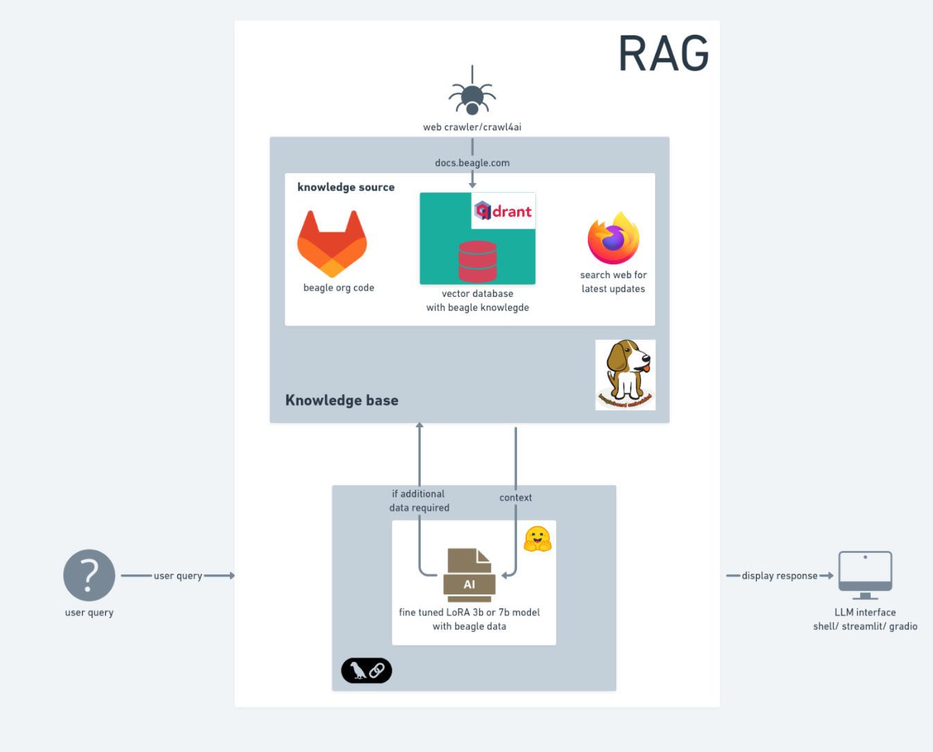

Hey @Aryan_Nanda,
I have made this architecture for the RAG project, so check it out do let me know if this is the way you’re planning to roll out the project?
This architecture looks nice and shows you have a basic understanding of the project.
Detailing how you will perform each step will be the key here.

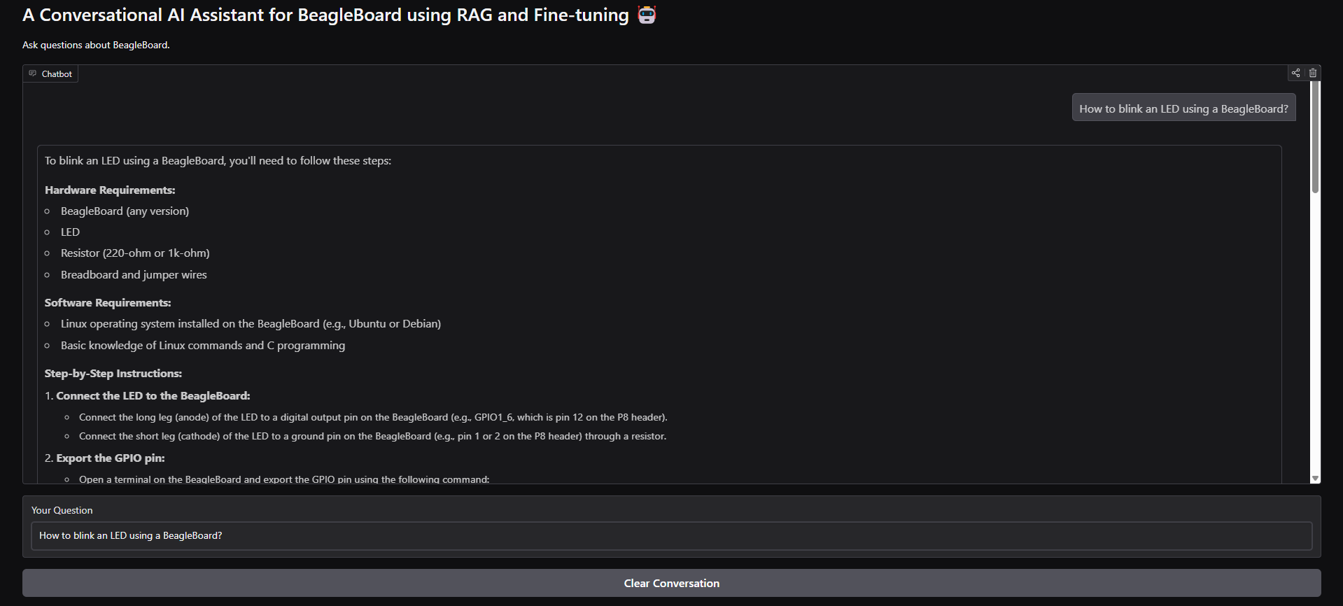

Hi everyone! I’m Fayez, and I’m interested in participating in GSoC 2025, particularly in the project “A Conversational AI Assistant for BeagleBoard using RAG and Fine-tuning.”
To better understand the project, I built a small demo where I:
  • Scraped the documentation repository from OpenBeagle (docs.beagleboard.io) using gitingest
  • Embedded the data using OpenAI’s ADA model
  • Stored the embeddings in ChromaDB vector database
  • Used LLaMA 3.3 (via the Groq Cloud API for fast inference) to create a chatbot that guides users through BeagleBoard documentation
The chatbot is still a work in progress. I’m considering ingesting more OpenBeagle repositories so the assistant can become more familiar with the different BeagleBoard boards, improving both its accuracy and troubleshooting capabilities.
Feel free to check it out:
Chatbot Demo: https://bb-gsoc.fayez-zouari.tn
Hugging Face Repo: fayezzouari/BeagleBoard-Chat at main

@Aryan_Nanda
This is nice! You can also add RAG here to provide more context. You can submit a merge request with a detailed proposal here
Your proposal is good, and the timeline is well-structured. Do more research and add details about the methods you will be using. Adding a workflow diagram will also be helpful

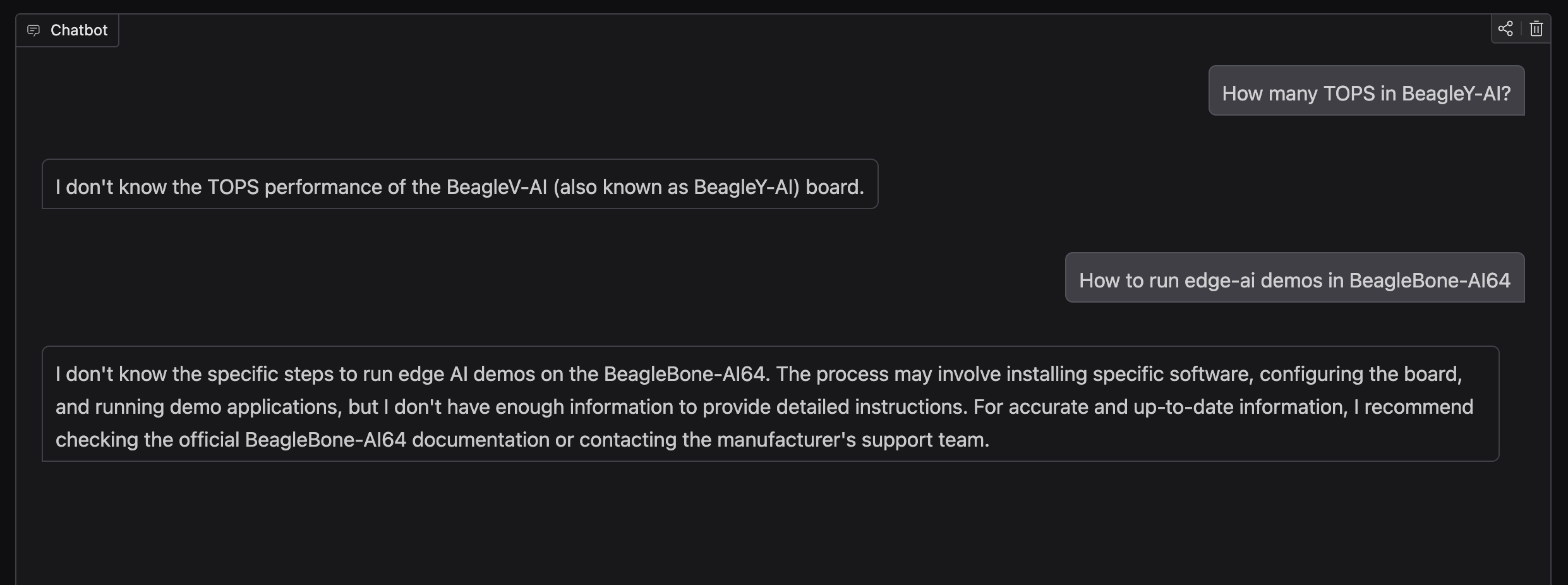

I am not getting any good answers, @FAYEZ_ZOUARI
Please look into this and also provide metrics on how this performs better than an LLM without RAG."
Setting the context is very critical, maybe some type of “preprocessor” to clean it up and refine or possibly open the scope like in this example.

Thank you for checking! Currently, the chatbot’s knowledge is limited to the documentation available in the OpenBeagle repository. However, I’m actively working on enhancing its performance by adding information from a broader range of resources. While it can already answer the questions you provided in the screenshot, (I made some adjustments and embedded more data into the vectordb), further improvements will make it even more effective. For testing purposes, we can focus on queries that are directly relevant to the existing documentation to ensure accuracy and reliability.
