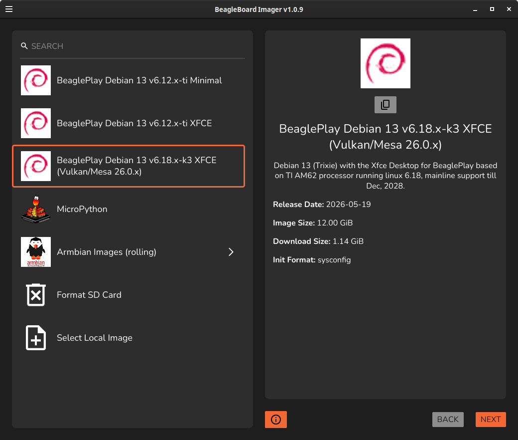

I booted it up, and was trying to flash a new OS to it with the bb-imager utility installed via flatpak.

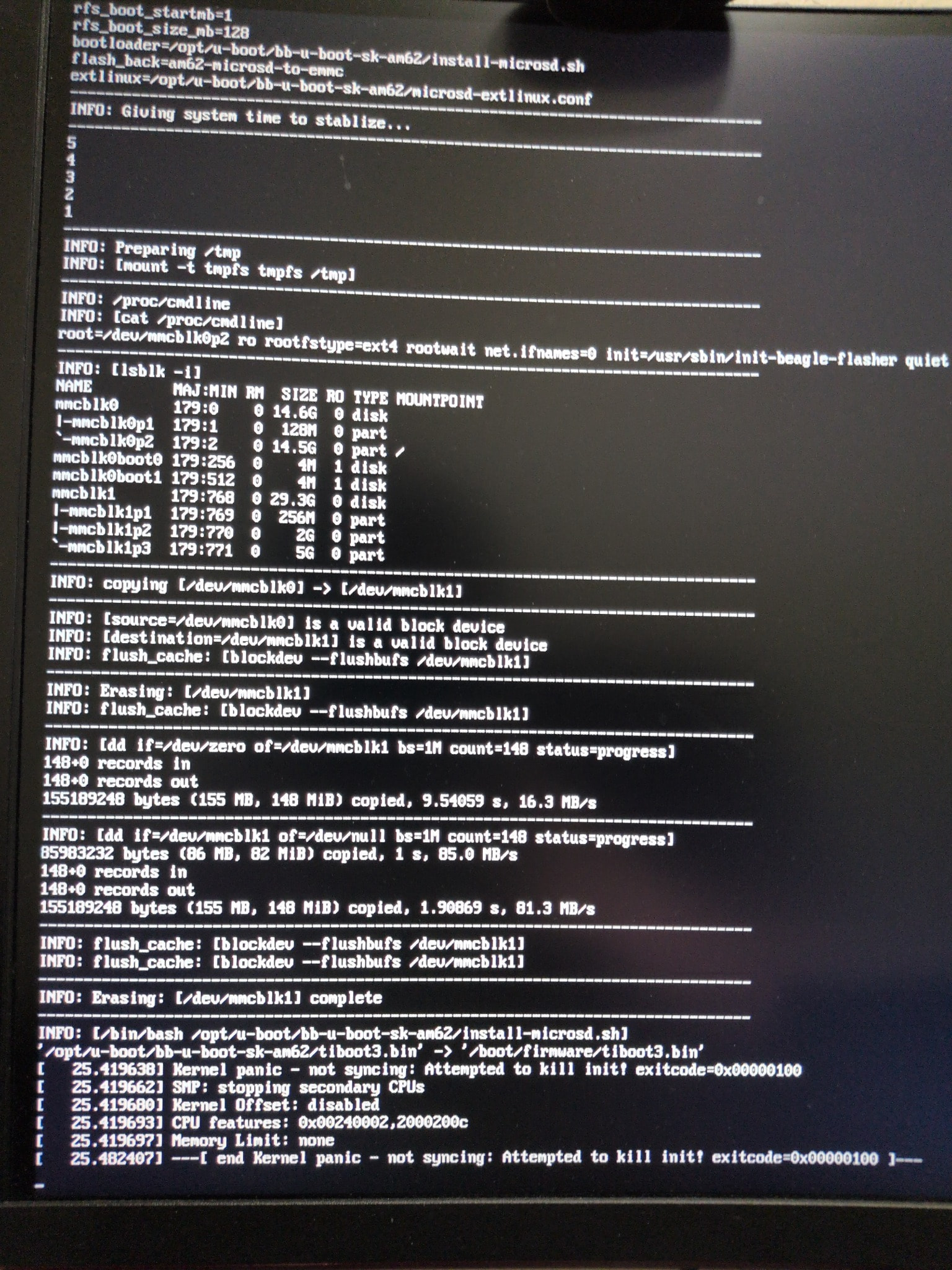

Upon rebooting my device. I got a kernel panic:
Obviously this is trying to do something that I wasn’t ready for and am in a bad state. How can I get out of this?

  • flashed every debian image from bb-imager and loaded with and without pressing the user button before power on (apparently to boot from microsd card instead of emmc)

On the BeaglePlay, thru the Serial Debug port, on bootup, select the boot menu option to “flash” the eMMC.
Please test with this image:
and please share the serial log, so we can the full log of what’s failing..
