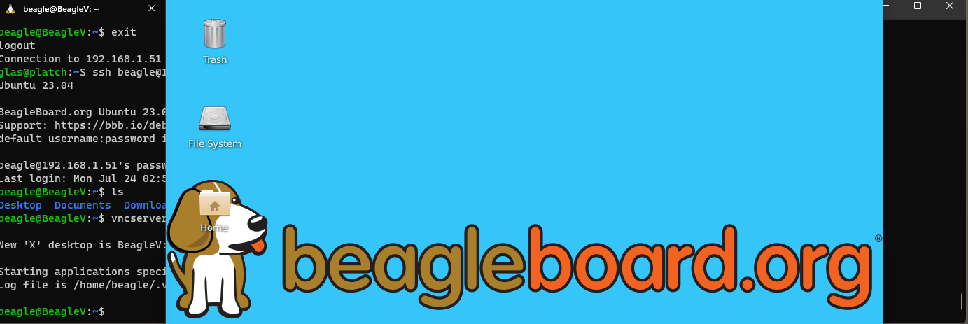

Here is the BeagleV-Ahead running Ubuntu 23.04…
