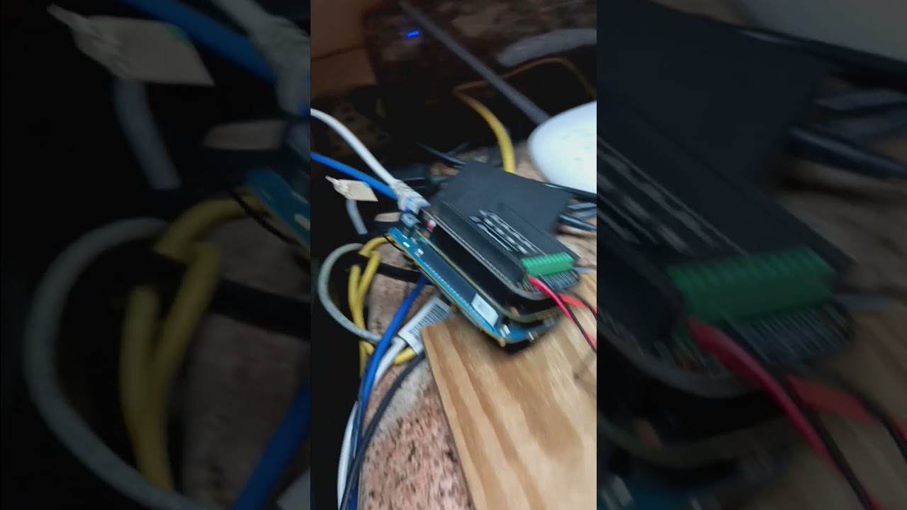

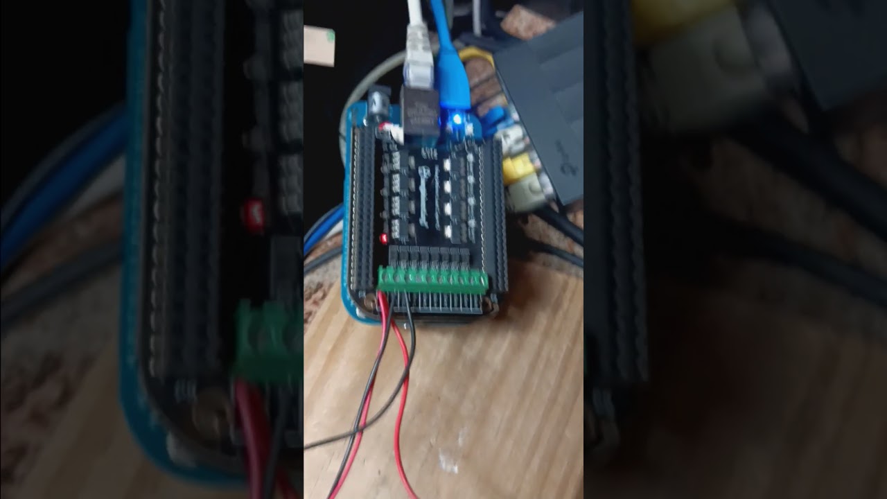

Obnoxious and belligerent is how you made me so far! Jokes aside, I was having some fun with the Load Cape and some Dayton Motor…9v supply!
Anyway, I decided to help out a bit in case people are not willing to test themselves.
P.S. And yes, that Load Cape works on the BeagleV-Ahead along with the Fan Cape cooling things off.
Also…I am "full" grown now and still love to toy it up…
No perfume for me, just straight electricity! Thank you to beagleboard.org for producing the boards and the fun and to an unknown source for the beginner software that handles the Load Cape locations via file descriptors and a specific lib… I got it to turn on and off. I see other entries at cat brightness!

I got it to turn on/off/end…
Forgive me for all the wiring and confusion. I finally got cmake to work too…
