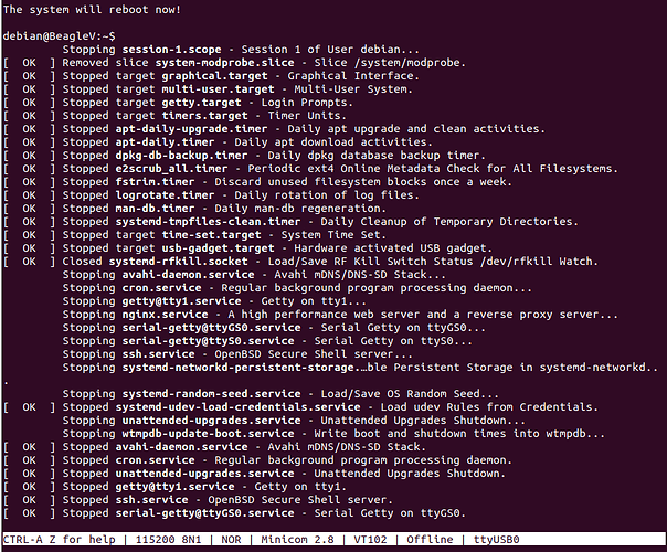

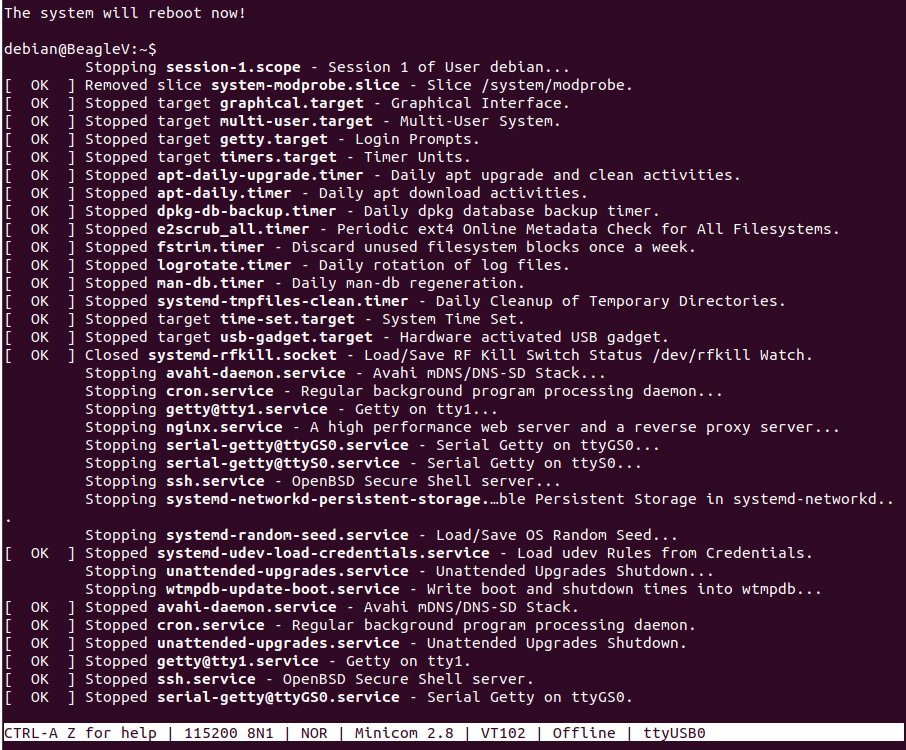

Whenever the change-gateware.sh command is run, it will show
FPGA update ready. The board will reboot now.
Then the screen will stuck here until you manually boot the board. Anyways the gateware can be flashed using some extra steps using the U-Boot scan

Ahh! The infamous “getty hang at restart” problem… @RobertCNelson
While this looks related to the FPGA reflash, please believe me; it is not.
Also, I don’t quite know what you’re trying to achieve with all of that copying.
Where did you get that from?
While very fancy-looking, loading the bitstream from u-boot does exactly nothing.
The real magic happens by presenting the bitstream to the kernel FPGA loader,
which is exactly what change-gateware.sh does; syscon doesn’t care at all about dram…
