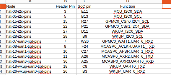

I was sorting out the pins and found what appears to be a conflict of uart6, appears to be 2 rx.
Attached is screenshot of the spreadsheet.
Yeap, uart6, which is shared with bluetooth… USART6 on hat header, shares with Bluetooth... (#38) · Issues · BeagleY-AI / BeagleY-AI · GitLab
I really didn’t want to copy the RPI3’s disable bluetooth to use usart… but we might have to…
and then what pair you want: 7/11, or 36/11
