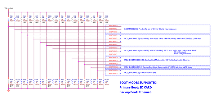

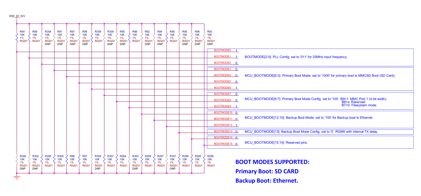

Yeah, the bootmode is configured to be uSD with a backup of Ethernet.
Check the TRM SPRUJB3 chapter 5 to see the boot modes. It seems the processor only supports USB device mode booting anyway, so booting from a USB drive is always going to require some other boot source.
