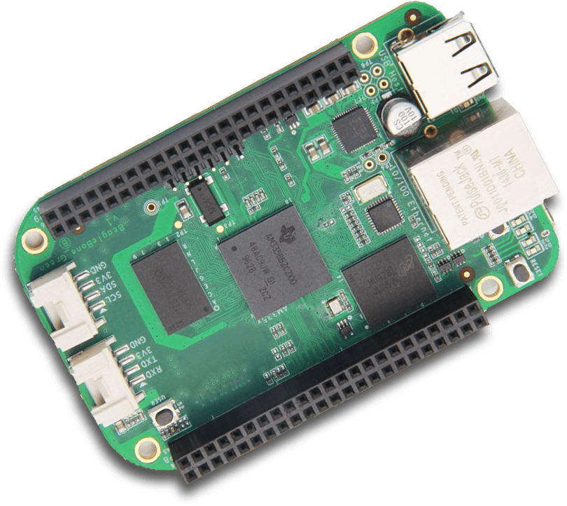

I have a couple of BeagleBone Green units I’d like to use in some prototyping work since I have them on hand. I don’t see an option for distros for the Green. What’s the best distro that I can use with it? I currently have a Buster image with kernel 4.19.x loaded. I only need to use an I2C bus and one GPIO for this project so it’s fairly simple.
Is there a Bullseye distro that I could use?
