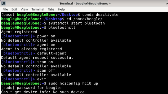

hi @silver2row i run these commands but showing like . can you please help me
Classic Bluetooth is not supported by cc33xx. Only ble, everything you’ve tried above and discord is classic Bluetooth. You need to use the ble only parts.
