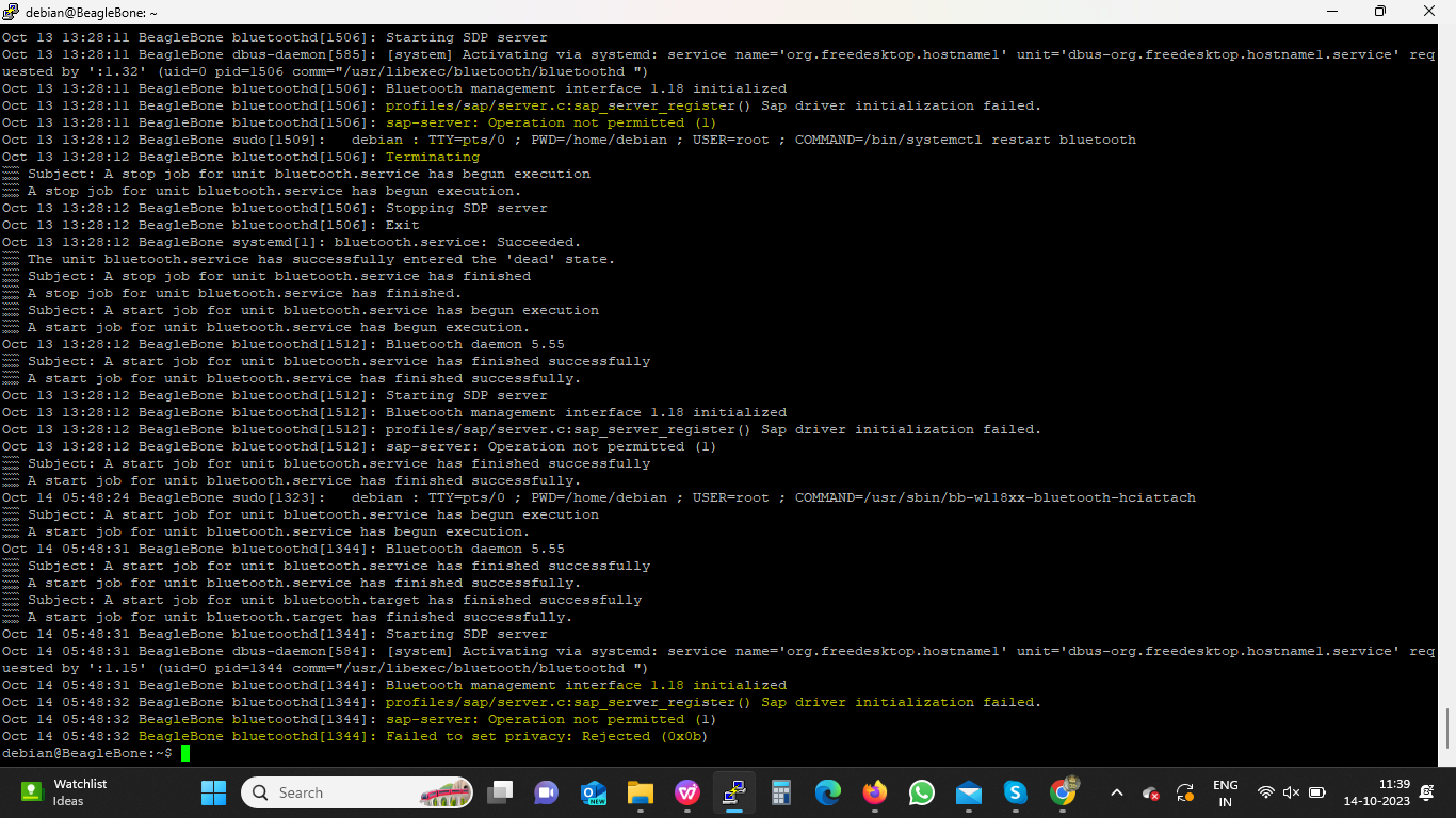

I am trying to share a file from my tablet to BBGW using Bluetooth. But it does not connect with the tablet. When I execute bb-wl18xx-bluetooth-hciattach, the Bluetooth is active; otherwise, it is in an inactive state.
I will attach a log file of errors please take a look on it; while trying to share a file or connect with a tablet using BBGW.
mainly it shows below mentioned errors–
  1. Sap driver initialization failed.
  2. sap-server: Operation not permitted (1)
  3. Failed to set privacy: Rejected (0x0b)
